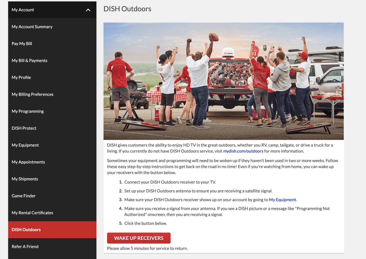

Go into MyDish.com and login. Then go to Dish Outdoors and press wake up receivers. That should wake up your HWS.

You must make sure that your receiver actually has a satellite signal and is receiving live TV (even if it is only authorized for the Hopper Insider channel) before going to the website to wake up your receiver. With no satellite signal acquired, the refresh signal will not do any good.

Update: Did some page by page digging on MyDish.com in desperation. Found a big red "Wake Up Receivers" button at the very bottom of the My Account>My Equipment page. Took multiple tries but when I walked back in the room and the program guide was in the process of downloading, probably woke the neighborhood up! Cancelled tech appointment online.
