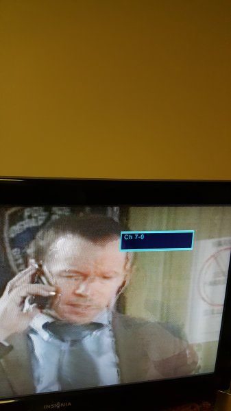

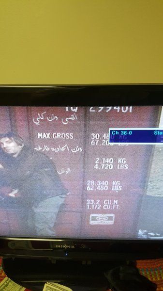

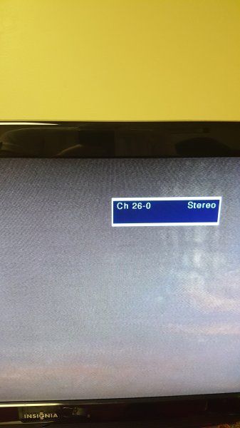

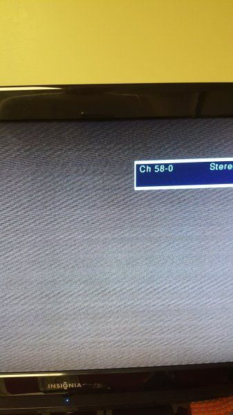

2. Our signal is fuzzy/snowy by the time it makes it to the rooms. I know this is a vague issue but would it even be possible to get a clear signal? We have 45 Dish receivers that run by fiber to a fiber to copper converter in another building about a half mile away. They are then put onto a combiner along with local channels, server channels, and AFN channels. This is run through a splitter to go to the various floors of that building where it is amped and split at each floor. Another run off of the splitter gets converted back to fiber to go to the dormatories where it is converted back to copper, amped and split to go to the different floors. At the end locations some channels are clearer than others. This is old copper coax that has probably been in place 30-40 years and I'm wondering if after all of the splitting and amping and converting from fiber to copper to fiber if a clear signal is even possible. All channels have a little bit of fuzz/snow with the higher channels getting more diagonal lines. The channels start very clear at the pick off from the receivers.
3. We get the America top 200 or whatever it is called. We are supposed to get several channels that don't come in like HGTV, Fox news, Cnn, Cartoon Network. They all say "Channel signal loss" when we go to them. I was told that this may only be possible to get with a "spot beam". Our satellite is 129 Echostar west (on the Super Buddy, it says 129 Ceil-2)

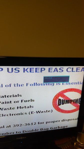

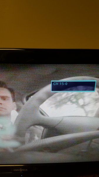

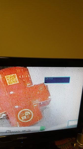

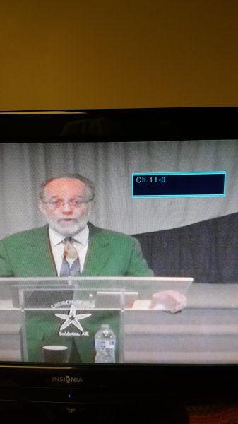

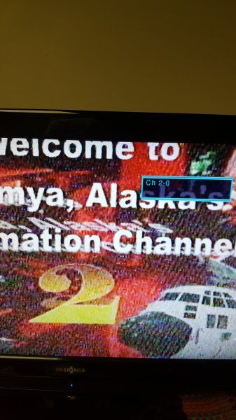

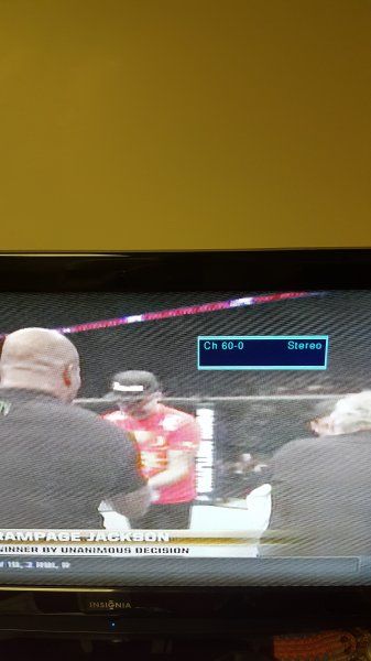

** I have uploaded how the channels appear in the room. It is still very much watchable but people want it perfect. I'm not a satellite/Dish guy, the Comm department just absorbed this when they got dish receivers.

The fuzziness problem you are having is not related to your satellite.
Satellite is a digital signal, so you either get a perfect picture or it blocks and has large squares in it where data is lost or total loss of signal.
Your picture problems appear to be somewhere in your distribution system, possibly due to corrosion of copper connections after the fiber to copper conversion.
Another problem could be the copper wire itself, is probably RG-59, which has higher line loss than RG-6, but the extent of your system sounds like replacement might be a big job. I'd exercise the copper connectors to see if I could knock off a few cobwebs first.

Thank you for the responses, We supposedly get the Conus feed, not the Alaska Spot beam. From the coverage map I don't know how but it works. So from what I'm getting as that some fuzziness on the TV's should be expected with our setup unless we are going to start replacing all of the cables. I pick off at the receiver site and they are very clear. After a half mile when they are converted to copper, still very clear. After they are fed into the combiner with other feeds, slightly fuzzy but still very clear. After the first amp and splitter, slightly more fuzzy but still pretty clear. I don't really see a breaking point, just progressivily worse down the line. And if I'm understanding right, transponder 17 just isn't strong enough to make it out here? As noted before, 17 is the transponder listed for the channels people want but we can't get according to "The list".
Jim5506
Jim5506
Oct 19, 2004
7,691
2,583
Lubbock, Texas
Signal in the fiber is probably digital, could be analog depending on how old the system is, converted to analog somewhere along the way, after the analog conversion signal degradation begins, you lose 1/2 of the signal about every 75 ft with RG-59, every 100 ft with RG-6, each split that is unamplified also cuts signal in half.
Very little loss in the fiber optic cable, depends on the category of the glass in the fibers, that's why it can run 1/2 mule and still have clear picture.
Sounds like what you have is an old style analog cablevision facility on a military base.
Back when we had analog cable it was not unheard of for amplifiers to go bad, especially on the lower channels 2-6.
Any idea when this system was put in?
