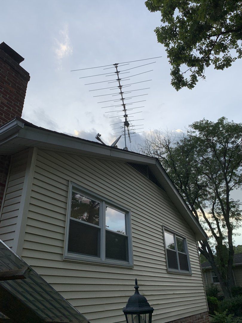

Huh. I think the longer elements aren't doing anything. How old is that? Do you have to use the rotator? All my stations are almost exactly NE from here, except for Manassas which comes in fine backwards on my antenna. I just use the AirTV dual tuner on the H3 for OTA reception (and recording). So, I removed all my distribution amps and just went direct (no splitters) to this thing: Xtreme Signal 70 Mile VHF/UHF Yagi Outdoor TV Antenna (HDB91X) from Solid Signal
I no longer use the mast mounted amp- its bypassed. I rarely use the rotor. Those two were for trying to pull in Hagerstown in the winter, to no success.

Antenna is maybe ten years old. SWAG.
Your link is to an antenna. I am happy with my home antenna. I am considering if an antenna like you linked might be better for my trailer than the current 8 bay CM (old 4040? Looks a lot like the 4228 but 8 separate grids). And I'd put a rotor on it. One station in an off direction might be receivable. But not important. It's almost exclusively MPT we watch there. And I'll probably put off any antenna replacement until next year.
Next weekend we go there and I'll rescan and go from there.

I took your comment about the removal of the distribution amp to the next step, just try a splitter. I want at least three locations to have OTA. But we watch very little OTA, so I'm not concerned about missing some stations.
I might buy the antenna you linked, but for our RV, where I have an old style CM 4228. I'm not sure why the yagi style would beat the flat 8 bay, but might try it. I'd love any discussion comparing the two styles of antenna.
I might also put up a rotor at the trailer. After the repack, there's an off axis station we might be able to pull in. But to be honest, we only really want the Hagerstown MPT station. We're not that far from the tower, but lots of trees between here and there. So we do have dropouts and sometimes lose reception. I can move my disused amp from home to there, but I doubt that would help.

Oh. Well, I was advocating for a quick check (direct without any amp or splitter) to a good tuner to see if your antenna was good, and then putting in a different/better distribution amp if the antenna tested out well.. IMHO you should get over 60 stations counting all the subchannels. From what I've read, that 8-bay should perform well. I still don't understand how you could get so few stations.
