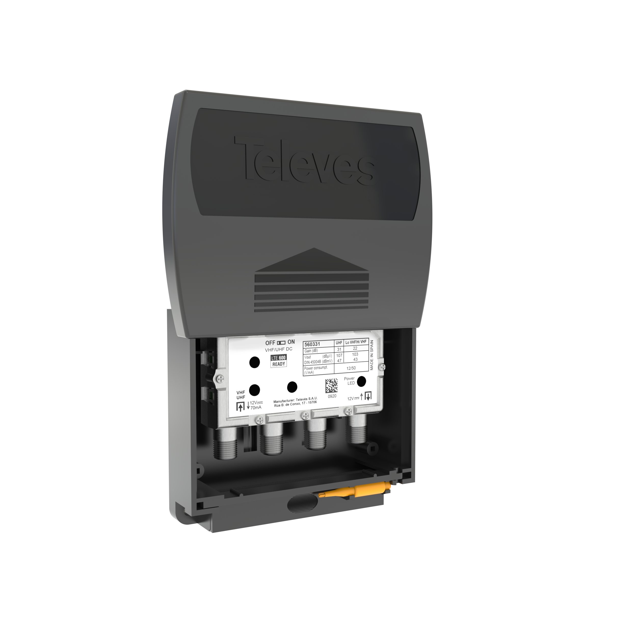

Channel Master 7777 mast mounted Pre-Amp
I think it's entirely possible that this pre-amp is causing your issues. I can't use one in my area, because even a single strong channel can swamp it in odd ways.
I switched to a Televes 560383, and pretty much solved my issues.
As an antenna installer, I have seen many of the old 7777's that the switches inside went bad/noisy. You can try either cleaning them with some Deoxit, but the real fix is to take the preamp apart, remove the switches, and solder jumpers to the positions you want. Not sure why you are getting Phila, and nothing on WB. The other thing that can be happening, is you have a cell signal in the 700Mhz band that is overloading the preamp. You could try one of the new 600 mhz low-pass filter on the input from the antenna. I am 77 miles from Penobscot Knob where the WB signals are. They are also our local channels, but over the repack our 16, 44, and 56 have gotten better due to the lower rf channel they are using. I get a -18 db barefoot (no preamp) here on 16 and 56.
