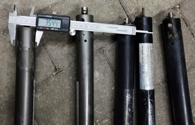

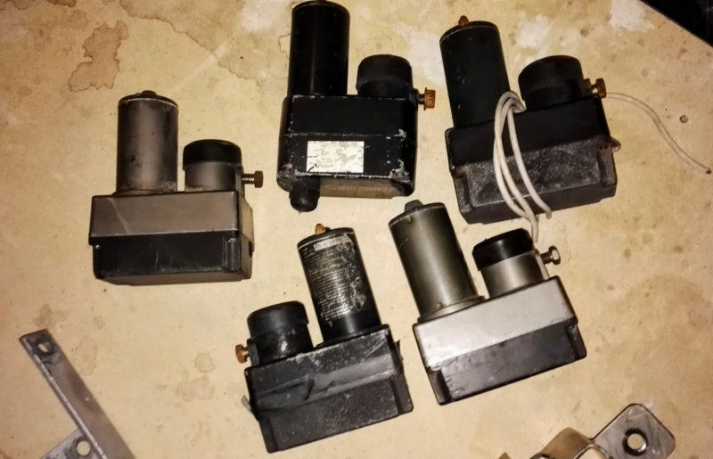

I have some of the motors available. If you give exact diameter of the tube of the actuator and can compare to motors I have. I also can check workability of the motors before you decide whether you need it or not. Shipping could cost ~10 bucks.
This is the tube size I found at http://www.dmsiusa.com/linear-actuator/ : Tube Diameter: 41.275mm / 1 5/8 inches
Actuators I have are 18' and 24' long and have tube diameter about 35mm.
