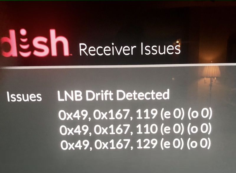

Well I was going to post a new topic but it looks like this has been discussed before. The only thing is that over the last few months (6 or so) I've lost signal on not just on very rainy thick days, but sometime just overcast days.
I ran across the attached message when I started to do some diagnostics and was going to schedule a call to Dish to have someone come out and re-point (pinpoint because I will be there insisting that i read the meter myself) the dish but then saw this.
I still may have someone come out to re-point the dish, but are others seeing this when they go into diagnostics and run the Check Status options. It says status OK, but when you drop down one to the show status box this pop's up.

That looks like what I saw, when I made the post right above yours.
