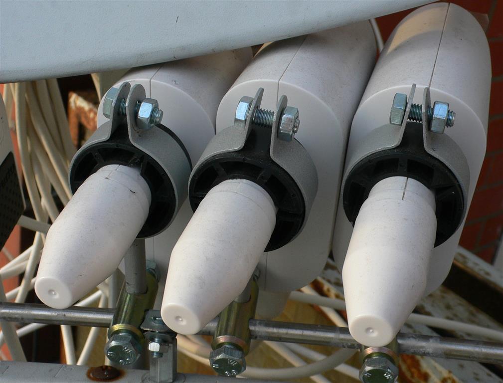

I installed a few T90's years ago. Would not attempt a monoblock LNBF for two satellite reception as the separation between satellites cannot be optimized.
Use the reduced scalar type LNBFs models for satellites spaced less than 5 degrees. Regular sized scalar LNBFs cannot be positioned close enough to receive satellite positions spaced 4 degrees.

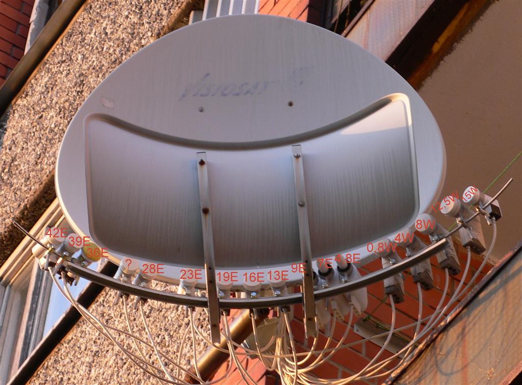

Hamed.Begloo I have one, for more than 10 years already. Now I only use it for watching TV, but earlier spent quiet a bit of time tuning it. 2* separation between satellites is possible with narrow-headed LNBs, something like this P1150549-1 (Large).jpg . And 3* separation is not a problem for 2 usual-headed LNBs setupApr24 (Large).jpg . Original LNB holders are not very handy to use, but still possible.
1,5* between satellites on one LNB perhaps possible. For example 4*E and 5*E can be received by one LNB.
What is this "reduced scalar type LNBF". When I googled the phrase, it showed some LNBs which seem to be even bigger in size than regular LNBs. One photo was like this:
BTW If I unscrew that bolt on the LNB neck, will it be what you said?
Besides are they weaker in signal reception than regular LNBs? Do they have low noise figure too?
Hamed.Begloo I have one, for more than 10 years already. Now I only use it for watching TV, but earlier spent quiet a bit of time tuning it. 2* separation between satellites is possible with narrow-headed LNBs, something like this View attachment 113193 . And 3* separation is not a problem for 2 usual-headed LNBs View attachment 113194 . Original LNB holders are not very handy to use, but still possible.
Do you know the exact technical name of these "narrow-headed" LNBs so I can search them and buy them, or at least giving the link of one them on ebay? Of course are these LNBs strong in signal reception too and also having low noise figure?

They are same in reception. Some say that Inverto Multiconnect are not so good during the rain (that seems to be true). Good LNBs, quiet expensive though.
