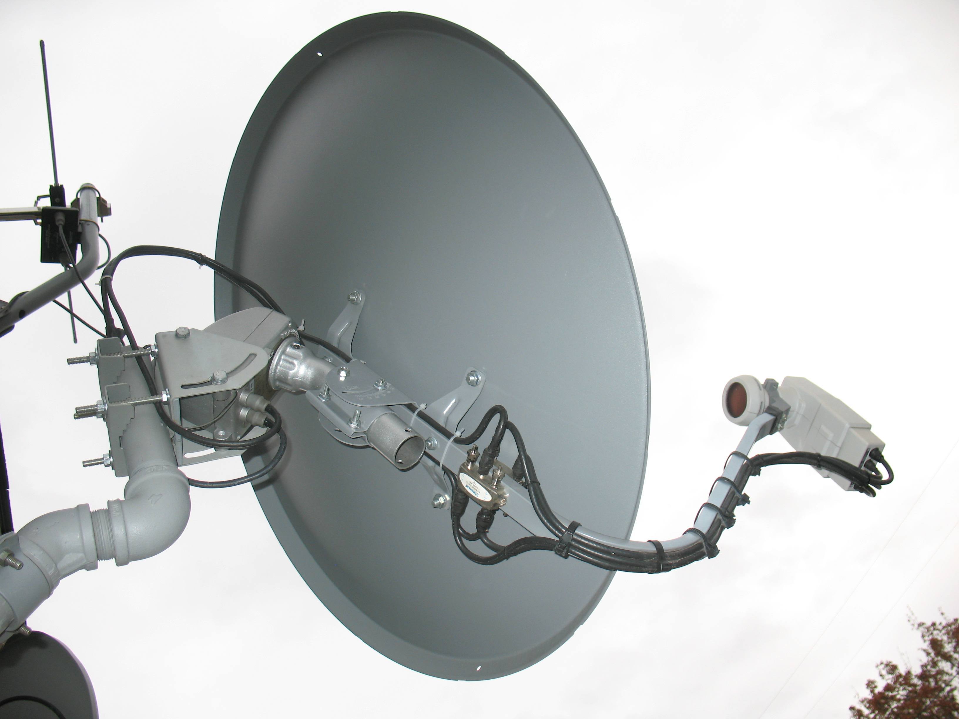

Nice catch! That was/is my first FTA dish also. But I might disagree with your assesment of the Invacom LNBF. I've had one married to my Winegard for ever.
Although the thought about the size has crossed my mind and I made a couple mods :)
Nice save indeed, and it was small enough that you didn't have to roll it home!

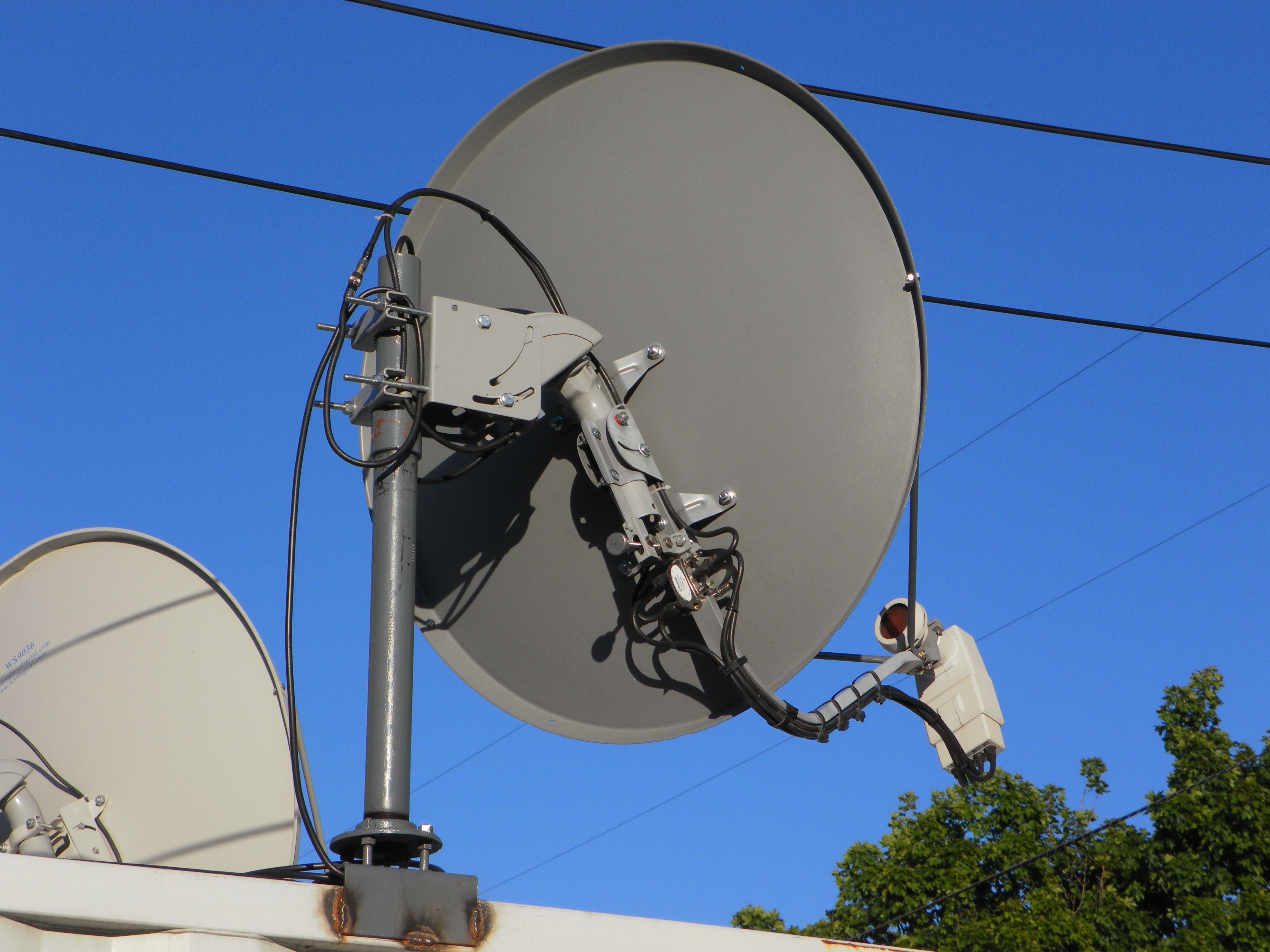

I did similar to what MS did on a Fortec (added side support arms) to help it carry an Invacom quad. Made them out of a couple of elements from a battered OTA antenna.
NIce catch. It's easy and cheap to build side support arms....
...for the lnb arm from 1/2 inch thinwall electrical conduit. The necessary holes in the dish edge were pre-drilled at the factory on my DS-2076 dishes.
I can post a picture if needed, but it's pretty easy to figure out. Getting the angles correct on the hammered-flat ends of the conduit is the only tricky part. It helps to have the dish right there with you at the workbench when you get to that part.
