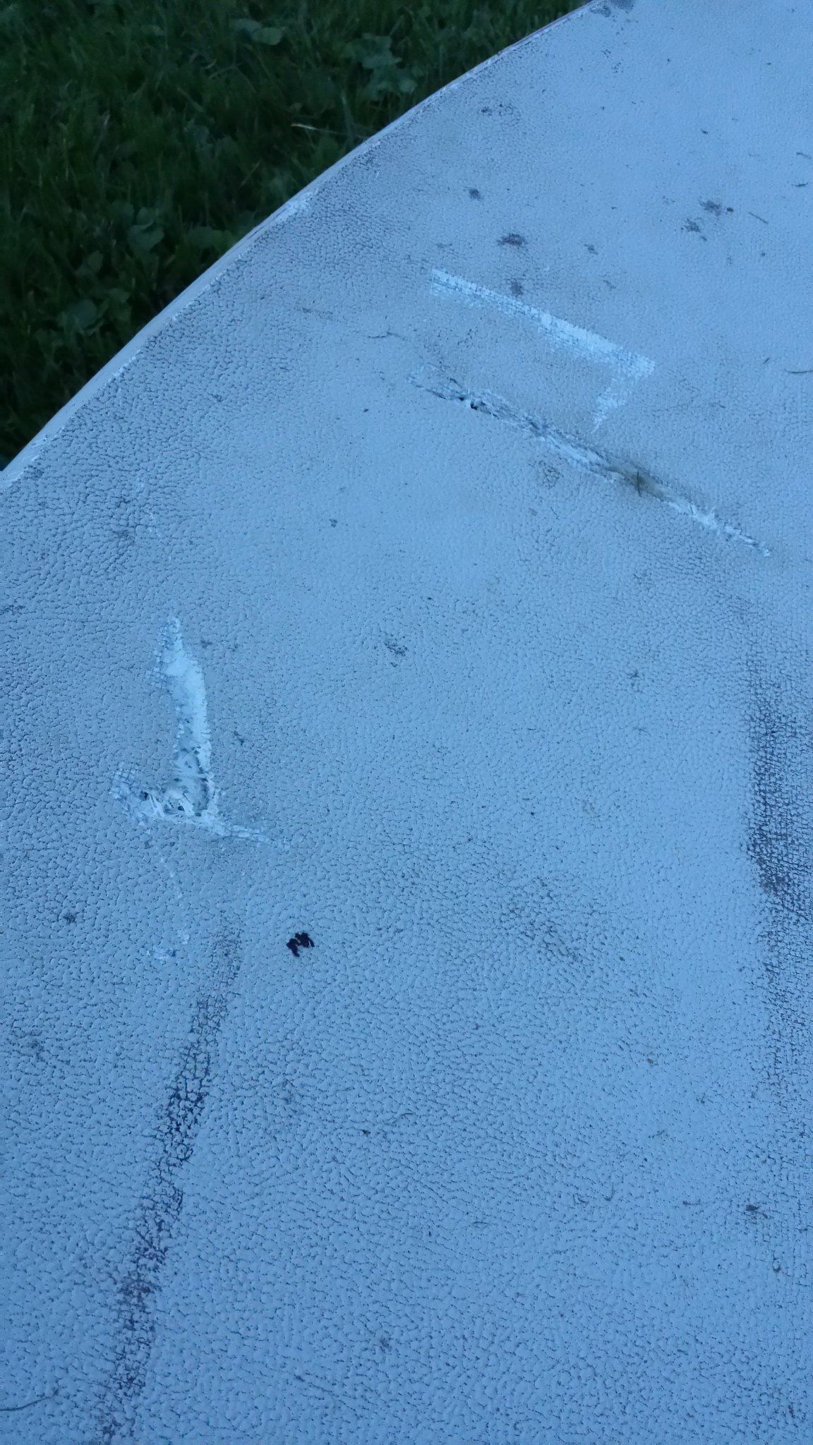

Okay, here's where I'm at. I've never done this before, so this spot is a good trial run more than anything. I got this and all the others prepped a week ago. This is the spacing I'm going to try on today just to see how it goes. The two spots here are both from impact on the face, as well as the cracked rib. The outside rim is cracked in this space too, but I'm not sure how to deal with that just yet.

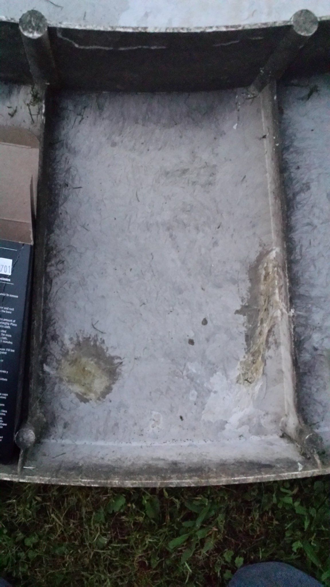

Anyone ever notice and wonder why your repair material sticks better to you and to the applicator than it does what you're repairing? :wtf2 Anyway, after a few cuss sessions and several attempts reapplying the material, this is what I have. I'm starting to feel sick from this too so I'm going to leave this go for now and bail.
Wear gloves and a mask. You will get the hang of it soon enough, practice and more practice. I was like you, a beginner in the art of fiberglass.
Don't be too stingy with the mat on the backside, that's where you will be able to build it up a little more to get your strength. It might be easier for you to use cut squares or rectangles, put some resin down, lay down the square/rectangular mat, then brush over with more resin. It was easier for me that way in the beginning then dealing with strands.

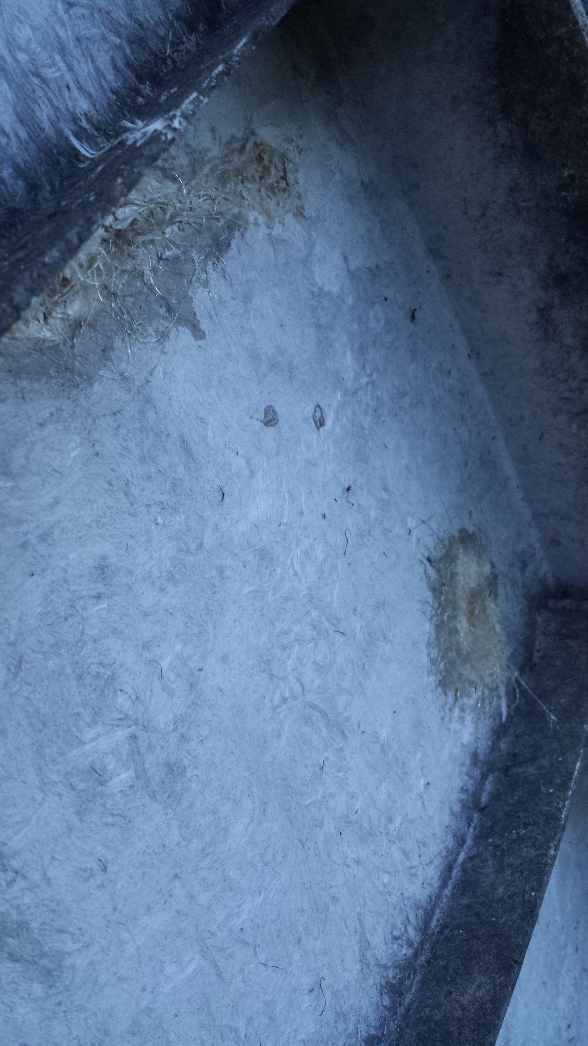

Something I noticed and is still the case, is that the material doesn't pack very well. I'm sure I'm going to have cavities, which will need to be busted back open and packed back in again.
Here's what I got.
Not near as bad as I thought it would be. If I can find a way to get this stuff to pack in better, the rest there will fill in nicely. There's enough spaghetti over the one hole and weathering around it that I should be able to throw a piece of mat or cloth on it and that will do it. Let's see what the other side looks like.
Some of it actually pushed through up towards the top. That's what sandpaper is for.

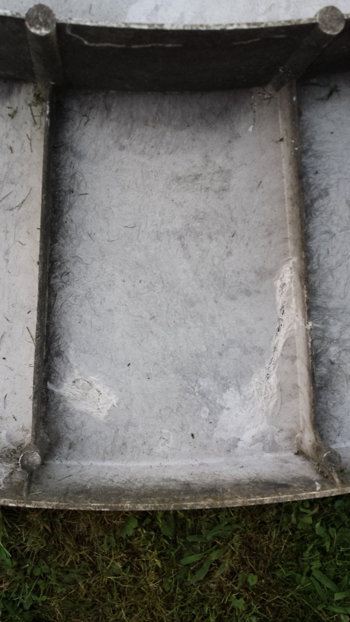

Yesterday's run isn't that bad, so I should be able to go over it again without having to undo anything.
Reactions: FTA4PA and fred555
It sure did. Set pretty solid and doesn't look like it's going to jump off of it either.

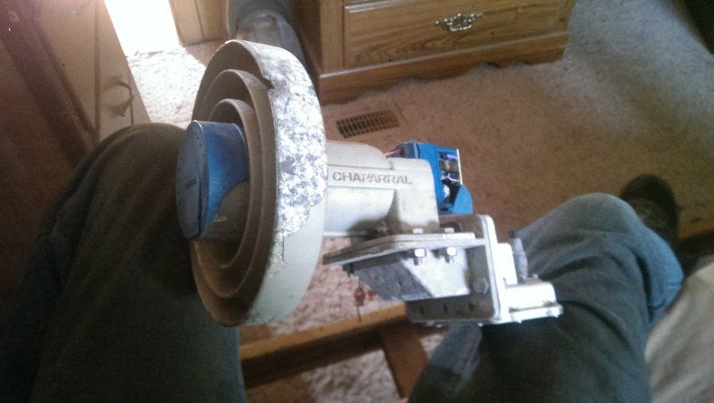

Update on THAT dish, that wasn't even supposed to be done with it. The owner was going to scrap it anyway, but didn't want the time spent fooling around with it and pitting up the lawn in the process. Upon discussing it with the owner, a chewing out session followed with the young man responsible for the damage to the lawn, which I kindly walked away from. :argue I think also being maybe just a little bit more upset that now his kid blew the sale on him by doing that instead of what he was supposed to be doing. Anyway, the feed horn with LNB was in the pile. And he offered it to me free of charge. :DIMAG0311.jpg
