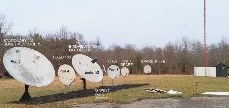

output 1: C-band on Birdview motorized dish
output 2: Ku band on Birdview motorized dish.
output 3: C-band on fixed Birdview
output 4: ku band on fixed 103 west
output 5: ku band on fixed 125 west
output 6: ku band on fixed 97 west (used to be 72 as in picture)
(spare ports 7 and 8 are not connected to any cables)
