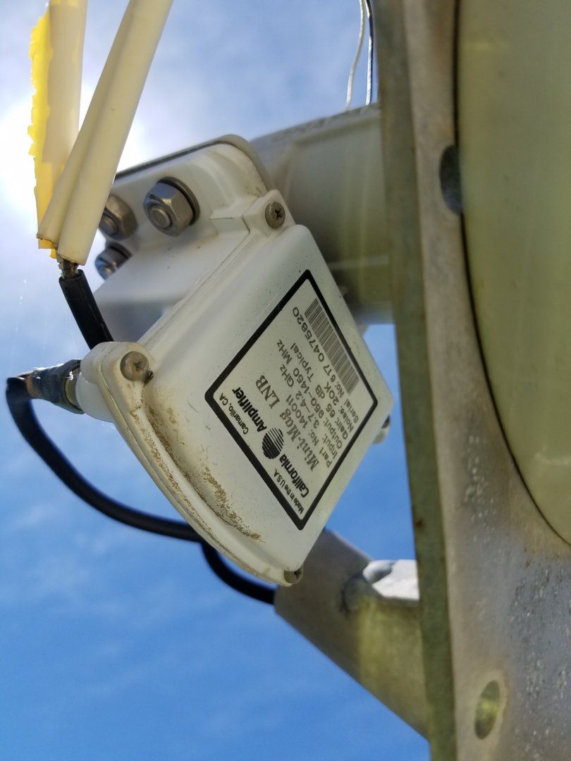

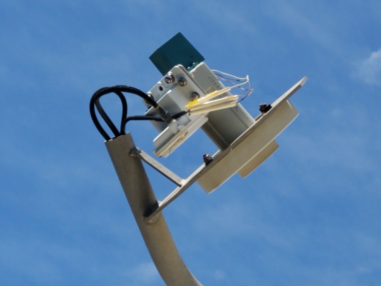

Thanks for the welcome. I screwed up. Went up there to look and realized It's an LNB. I don't remember changing it but then, I got the system in 1988. A lot of water passed under this bridge since then.

Welcome to Satellite Guys! I would recommend upgrading to a Titanium C1-PLL or C2-PLL lnbf:
and a new receiver like the Amiko HD265:
or Edision MIO.
I would recommend an ASC1 dish mover but they have been discontinued. You may still be able to find one if you look hard.
You can still use the 450i as a manual dish mover though. :)

Not unless you have an old analog receiver. Most people buy a separate diseqc capable dish mover (such as a Vbox or Gbox) that responds to diseqc commands from the FTA receiver (such as the osmio4k or amiko or similar receiver). Those commands are sent over the coax between the receiver and dish mover. Those commands are then decoded by the dish controller and sends out motor control of the actuator and polarity control for the LNBF. If you are using a regular LNB with polarity control via servo motor then you'll need an old analog receiver. I suggest changing the LNB to an LNBF since it would be less cumbersome.
