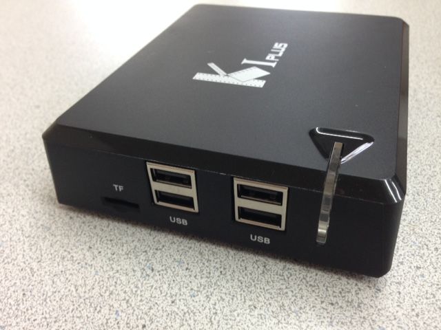

Well, I'll get this right out of the way at the beginning of the first post of a thread for another STB.... I took one for the FTA team! The STB has great possibilities, but out of the box, not a strong contender as the DVBS is the standard DTV app. http://www.ebay.com/itm/201544884463
The K1 looks great on paper, quad core S905 performance is exceptionally fast and Kodi works great! DVBS2, well not so great... Here is a great thread that got me interested in testing the unit: http://www.cnx-software.com/2015/11...ic-s905-android-tv-box-unboxing-and-teardown/
IMG_4374.JPG IMG_4375.JPG IMG_4376.JPG IMG_4379.JPG IMG_4380.JPG IMG_4381.JPG IMG_4382.JPG IMG_4384.JPG IMG_4385.JPG IMG_4386.JPG IMG_4387.JPG

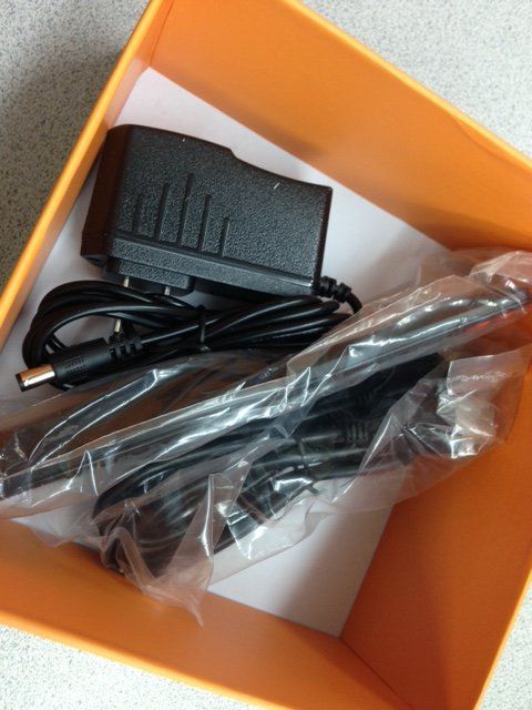

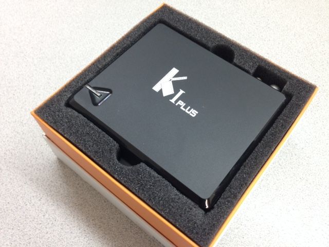

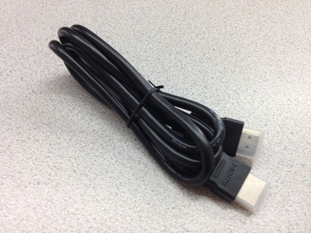

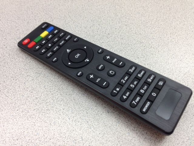

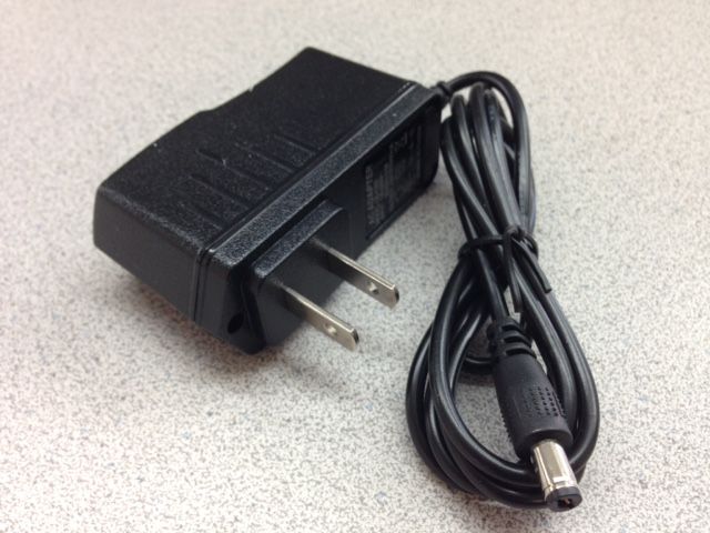

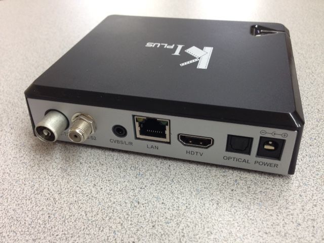

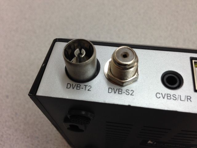

Very nice presentation, well constructed and packaged well. Includes the North American AC/DC adapter, HDMI cable and a standard IR remote. Includes a DVBS2 and T2 tuner. The factory states the availability of two DVBS2 tuners or DVBS2 and ATSC, but only could get this sample. Memory is RAM: DDRIII 1GB and Rom: Flash Nand 8GB. Only has USB 2.0 ports and TF supports up to 32Gb. 2.4G WiFi internal and HDMI 2.0. The included remote provides access all menus and settings, but I connected a wireless keyboard/mouse for ease of set-up and input.

The menus were clean and easy to navigate and there was no lag on the remote or keyboard navigation. The DVB app opens to select either the DVBS2 or DVBT tuner inputs. No North American satellites, but it was fast and easy to add the satellites visible in my location. The install menu allows simultaneous switch and motor settings with 22KHz, DiSEqC 1.0/ 1.1 and motorized 1.2 and USALS. There are 64 DiSEqC 1.2 user assignable satellite motor assignments.

Noticed the power supply is rated at 12V 1A. Wonder if a beefier power supply would allow motor operation without blowing up the main board?

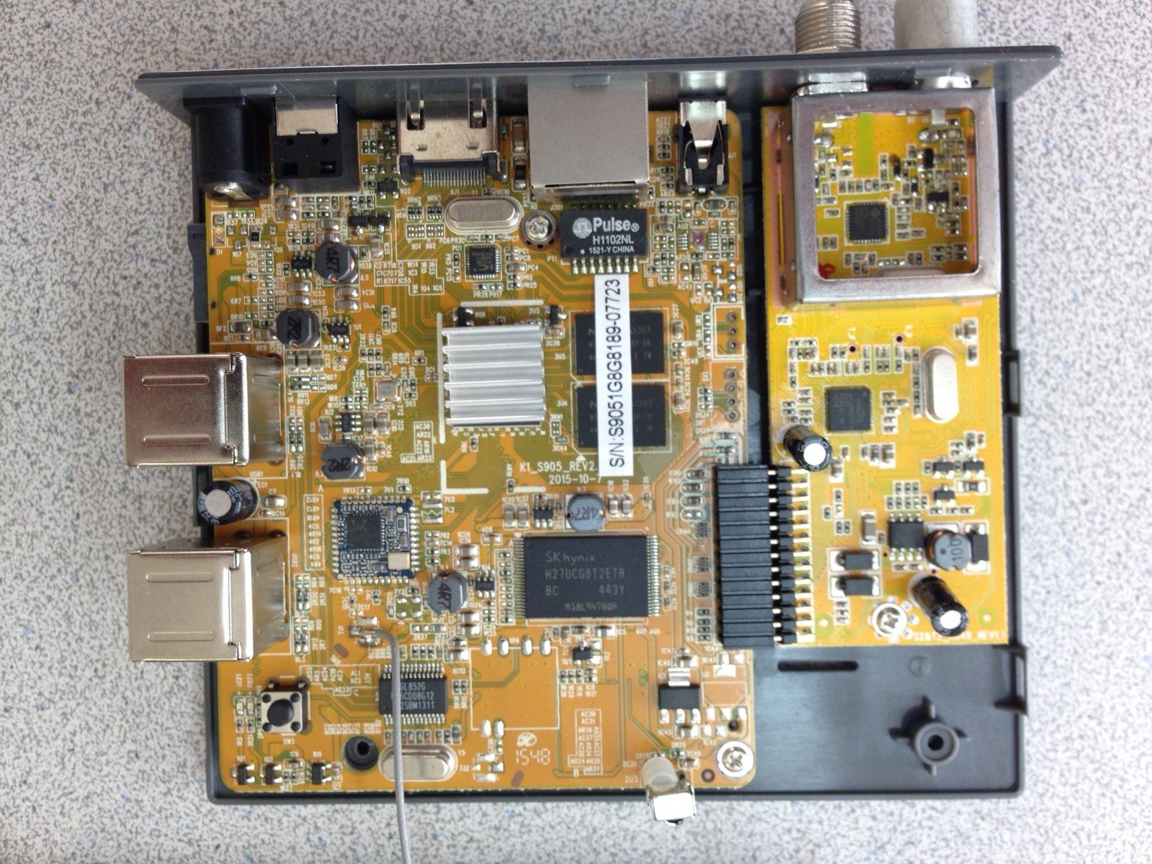

Definitely disappointed by the lack of 16APSK as I feel that this is a must for any new receiver. Not sure if it is a tuner limitation or just not firmware enabled. Will tear down the unit and verify the tuner build.
The hardware specs don't provide much information. I will also load the LNB IN port and determine the current limiter protection setting, hopefully it has one! Otherwise, this testing may be ending soon... :(
Increasing the available current on the DC input shouldn't have any effect on the available output current. Increased power supply amperage cannot damage the unit but increased voltage certainly could. As long as the minimum voltage/amperage input is available, the output current should be constant as it is a combination of the regulator components and firmware limit settings.

Definitely disappointed by the lack of 16APSK as I feel that this is a must for any new receiver. Not sure if it is a tuner limitation or just not firmware enabled. Will tear down the unit and verify the tuner build....
I believe it has the Availink AVL6862 demodulator which only does QPSK and 8PSK. Probably no possibility of a software fix for 16APSK. :(

Opened the unit and the users swap-able tuner board has an Rafael r848 tuner (42 - 2300MHz), Availink AVL6862TA demod.
Quite interesting if SDR software could access these T2 and S2 tuners. Imagine the capabilities with coverage 42MHz - 2300MHz and bandwidth of 4-40 MHz. :)
