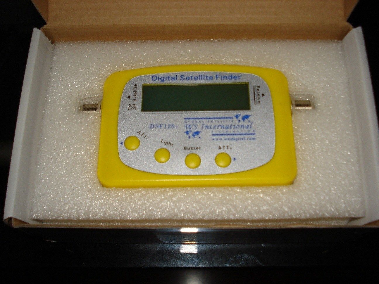

Out of the box the meter was larger than expected. That is a plus for me because I have large hands and the meter size is important to me as smaller meters tend to be harder to hold or fingers get in the way of the display and controls.
The color, I like makes it easy to see in low light environments.
The texture of the meter, wasn't smooth I consider that a plus.
Display, Larger enough I can see at a comfortable distance.

The buttons are easy to select and press and are placed far enough apart I can press each one without hitting the other. I have large hands and fingers and this added feature I really liked.
The silver faceplate sticker I really didn't care for as I noticed it hadn't been pressed down well. It looked like it had already started to peel on one side. However, I did like the labeling for connections on the front that's plus.

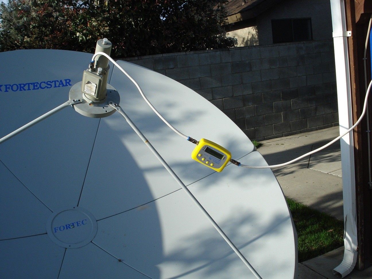

For my test I used the following:
6ft CBAND dish with Cband LNB
Sonicview 8000 HD receiver
113w Satmex 6, transponder 3748 V
Prior to connecting the DSF120+, I moved the 6FT about a foot west and the elevation about 6 inches up. So obviously my signal was at zero.
Powered the rear switch from the SV8000HD and connected the DSF120+ between the CBAND LNB and the Cable heading to my 4x1 switch.
Ran back inside the house and powered "on" the SV8000HD and went outside again.
The meter showed no signal on the display, and started to move the dish to where 113w is located, as soon as I messed with the elevation the extremely loud BEEP was sounding alright (as other tester noted) and immediately pushed the BUZZER button and muted completely. I find this loud Buzzer a plus for some people that need to install a dish in loud areas. So it does have an advantage for some.
The display showed a signal of 99%, and as per the steps it says to hit the ATT button a few times til the signal reaches half the signal.
I got it down to 52% approx and then tweaked the dish a bit more til I was able to reach about 72% which was the max I can get. A very simple signal adjust that took me about a minute or less to find. In fact took me longer to connect the meter itself then the actual signal finding.
When all was unplugged, I checked the signal level from the SV8000HD and it did show the signal in the 70's which tell me this switch does the job for me.
My overall experience was simple and efficient. No need to have big pockets to afford this simple but yet effective switch to peak your CBAND/KU dishes.
Give Robbie a call at WSI for the DSF120+ meter if you a guy like me that has a 6FT dish with no motor for manual ghetto signal finding and add this switch to make things much easier to find the signals.
Robbie, thanks for the meter. This is something that will be with me until it break hehe..
BTW: I have attached a picture so you guys can see how see the DSF120+ in action.
