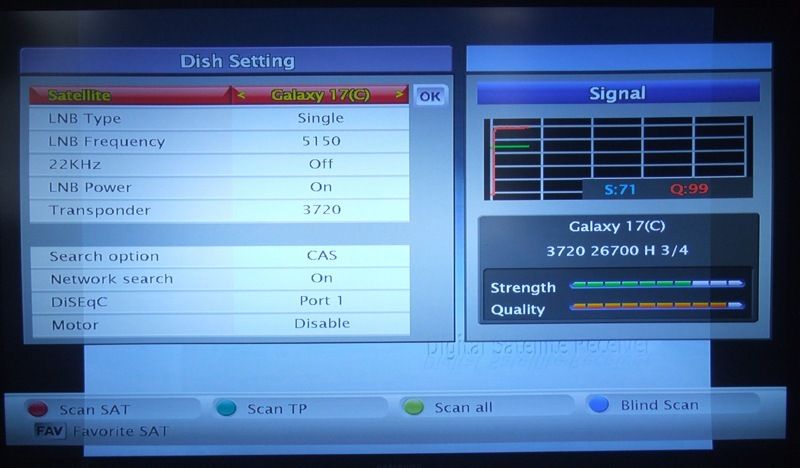

I use the 8000 with a USALS motor. It does an excellent job of driving/guiding this motor. I had the USALS part of this working well at one point. I disconnected my HH motor when I was using a GBox for my BUD (pre 4DTV), and I haven't gotten the USALS to work correctly since. I will try to look into this and follow up on it. Since USALS was working well at one point I'm sure I just need to reset something in the receiver or on the motor.
This receiver does blindscan and it does it well. It will even find channels/transponders when you are not dead on the satellite, which helps a lot when you're not exactly sure if you're in the neighborhood of the satellite you're looking for. It is also very easy to tell when it encounters an active transponder, even if it is one it can't decode. This would make the 8000 an excellent companion to a receiver that was unable of blindscanning.

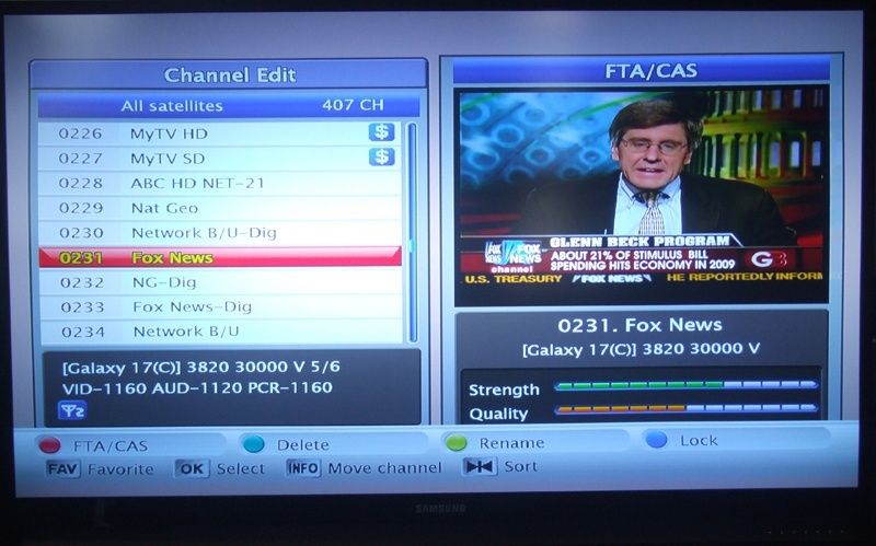

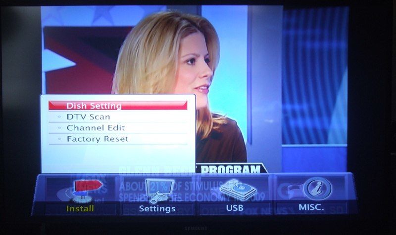

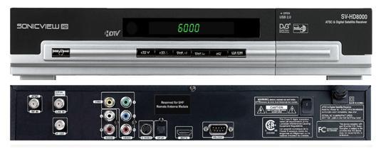

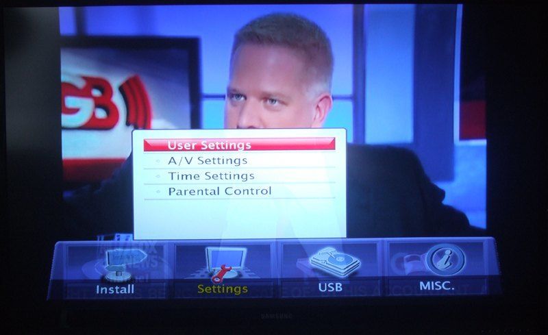

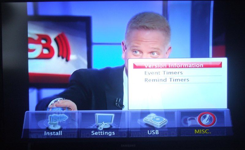

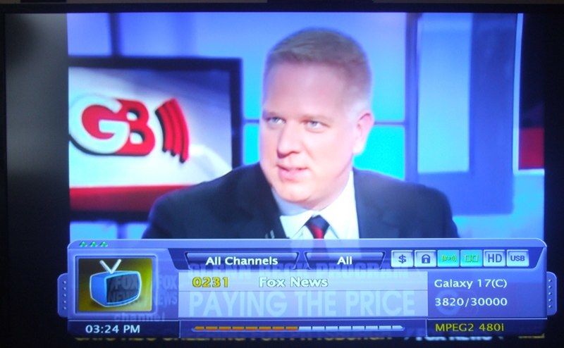

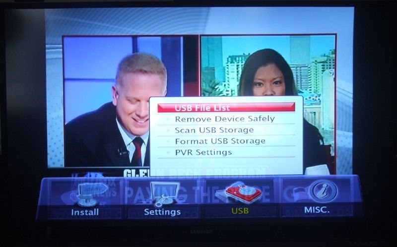

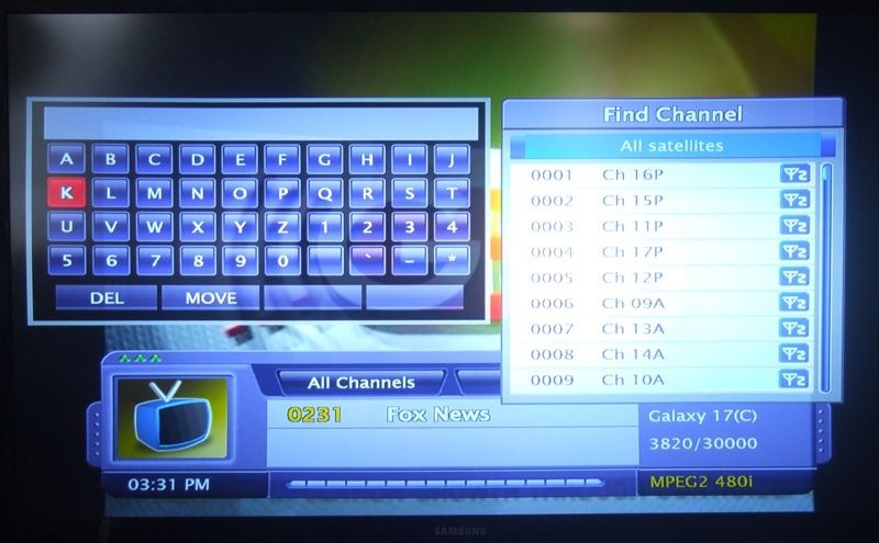

Edit: Added pictures as requested. I could not find anything bigger for the front and back views at the moment.

nice review :)
Any pics of the screens?

I might also ask for pictures of the front 'n rear, something good enough to zoom in on and read the printing.
Maybe even stolen off an existing web site.

As far as switches go...so far I've only used 1x4 diseqc, a 22khz, and a 2x4 multiswith. No problems with any switch configurations so far.
I do have pictures. They're on my camera. I'll have to wait until I get home to upload them. I'm at work right now. Won't get home until much much later tonight.

Now let me get those pics uploaded.
