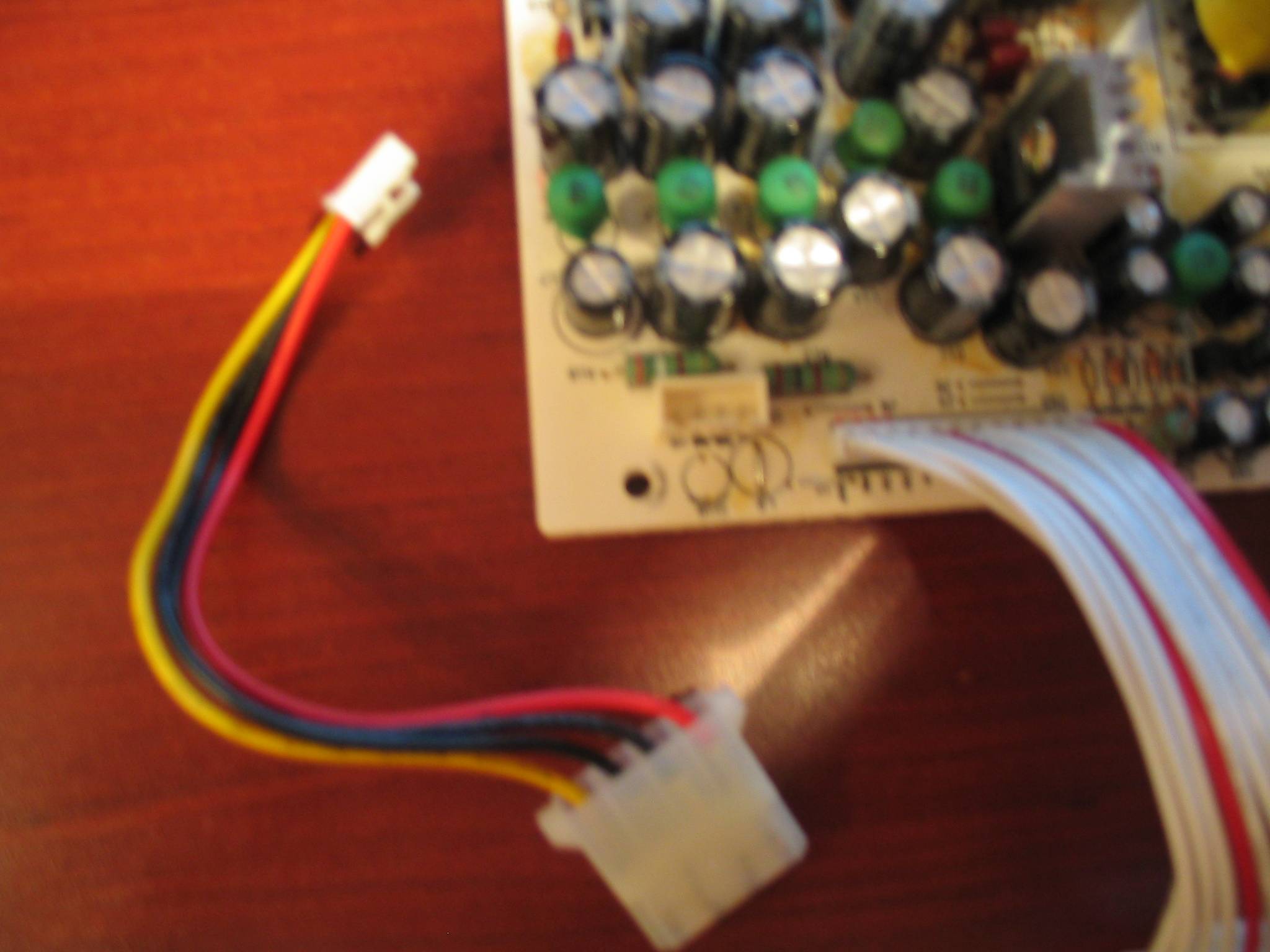

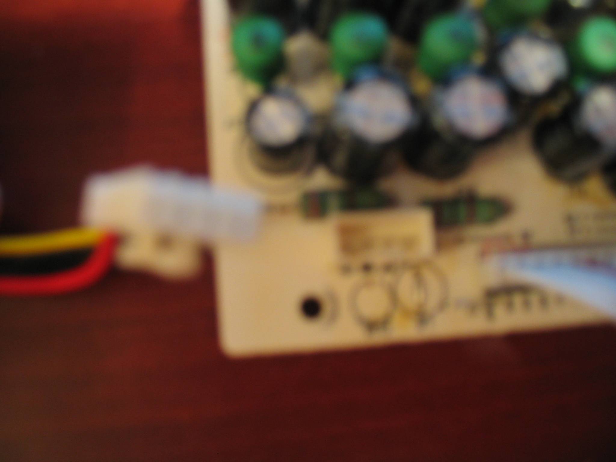

If you replaced the rear internal fan since its died, did you notice where it was connected to power source: on the Main Board, or underneath or on top of Power Supply Board? What color is your Power Supply Board: green like Main Board or whiter?
There is a power connector on the Main Board of SV-8000 V2, I connected 6V bigger Diameter quiet fan to it, glued it in the area btw Main and Power Supply Boards inside the receiver, directed towards Main Board, and its cool and quiet out there. No need for an external fan for me so far, but I'm thinking putting a second same fan model inside, directed towards Power Supply, as there's plenty of space in the corridor btw Main and Power Boards, and there are 2 power connectors under Power Supply Board. The noisy factory fan can be switched Off in this scenario.
Anyone knows, what exact type, or make and model number of 4-pin connector is used in SV8000HD power supply board and also in main board (to hook up the front panel USB board)? I can't find similar 4-pin connector or any "4-pin (Sonicview type) to 4-pin Molex" cable or pass-through (Molex) adapter cable to hook up extra 2 silent fans without splicing wires. See pic of the 4-pin connector attached.
