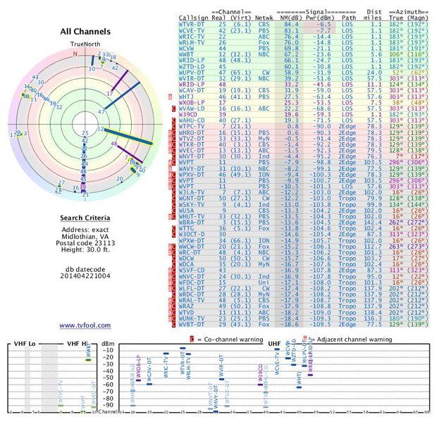

Here is my report http://www.tvfool.com/?option=com_wrapper&Itemid=29&q=id=e1c6f0e6ced69d

Thank you for the TVfool. YOU DON"T NEED A PREAMP tvfool shows broadcasters at 1.1 mile away from you. Your problem could be too much signal. If there is a strong broadcast signal it can bounce off buildings and arrive at your antenna out of phase with the main signal cancelling out the stations reception. You have about 18 stations listed as LOS line of sight so you have a good chance of receiving them.
Try a winegard HD1080 for both UHF & VHF reception in your attic. You have two concentrations of broadcasters one at 192* and another at 312* aim the front of the antenna at the more distant stations the "LOCAL" broadcaster are going to be so strong they will come in no matter where the antenna is aimed.

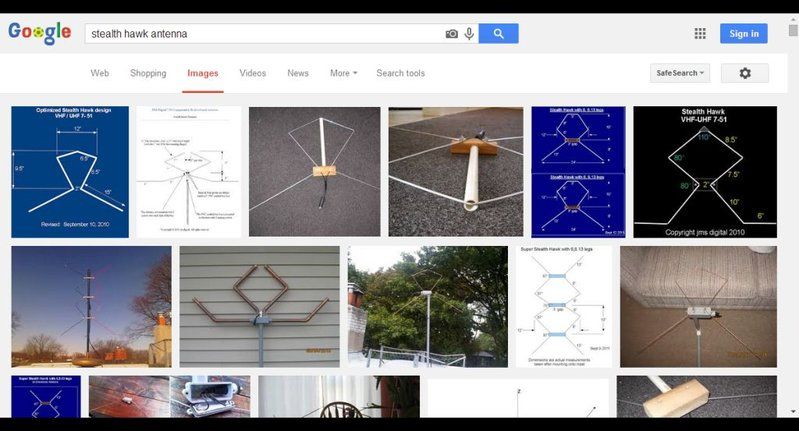

Being so close, I think I'd try a Stealth Hawk, (VHF/UHF omni) make out of some solid 14 to 10 awg.
Yeah that's the plans I was reading about last night. So it works pretty well? Wasn't sure if it was worth it based on price alone but satisfaction of building it would be nice.
From what I've read at digitalhome about it,it's a winner.
I'm building one, and most around here are 40 miles+. will let everyone here know how it works. For the price, which can be only a few dollars, seems like a no-brainer.

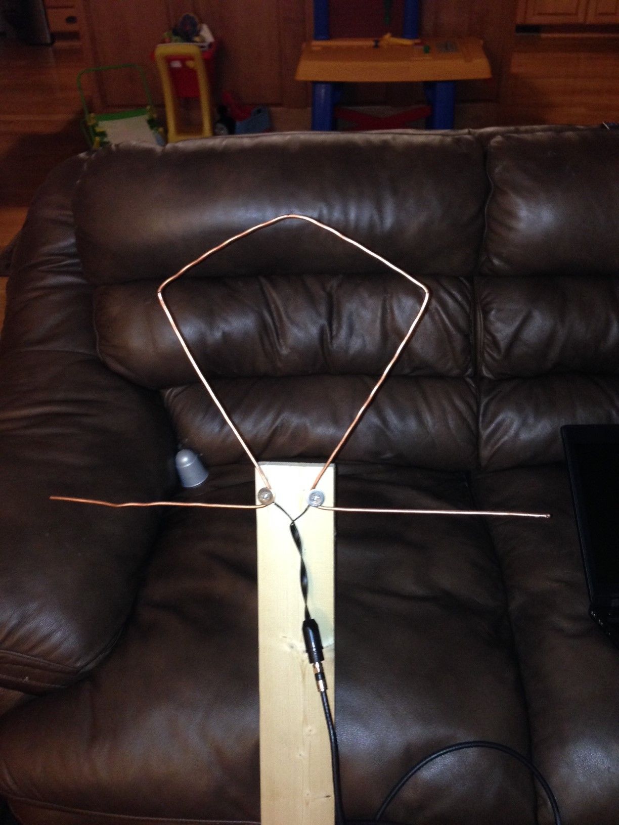

Finally built one, went back and forth on either a Stealth Hawk or a M4 design and I'm glad I went with Fat Air's recommendation. I'm getting all my locals as well as few stations that are a few hours drive away. This was from inside just next to the TV and on the 2nd floor. When I move it to the 3rd floor it should be even better.

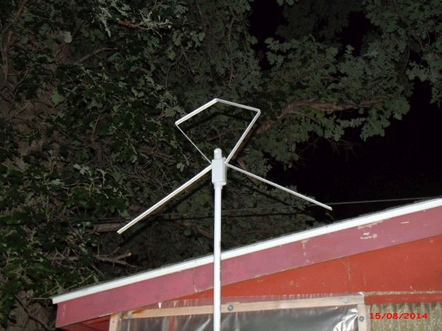

Cool to hear it's working. I built one also. Get's a VHF hi (rf channel 8) as shown* at around 45 miles.
Got to try it out 'in the clear' for a couple of UHF channels near 65 miles.
* 10 ft off the ground in amidst the trees and structures.

Your bends look nice, did you make a jig? I'm going to make another one for the attic and I'd like to see if I can make it a little nicer. I put this one behind my TV on the first floor that is still connected to DISH and it is working great there as well. I'm surprised since that part of the house is under a copper roof.
Nope, used a bench vise and hammer. (3/4 inch strap aluminum used)
If it's in the attic, who cares what it looks like, only important 'item' is how it looks on the TV screen. :)

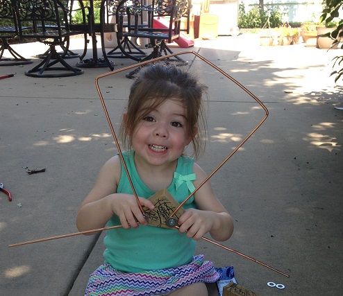

My daughter wanted to help out with the new one. Hung it up in the attic and used some old very thin and flat twin wire to get it where I needed so I can split it and run it throughout the house. Only two TVs attached so far but all the locals are coming in, just not the distant ones. I need to get some ends for RG6 so I can wire it up right.
If the 300 ohm flat lead is working you might want to leave it there, just not connected to the antenna. Flat lead will work as an antenna so what you are picking up for locals could come in on just the flat lead. Disconnect the flatlead from the antenna and twist the bare wires together to see what it is receiving.
