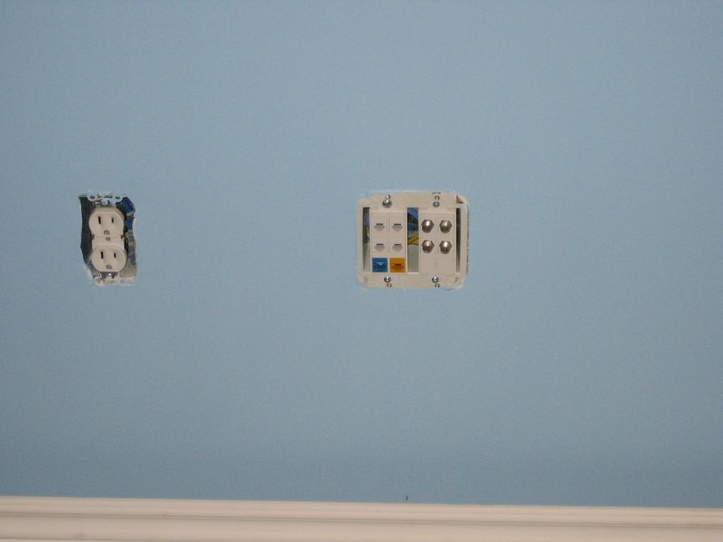

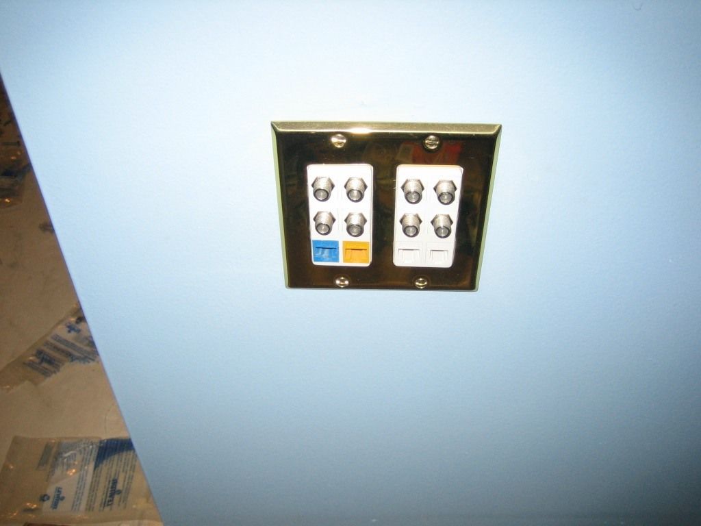

In the case of my house we have spray polyetheline foam insulation and I had to dig it all out back to the plywood sheething so there would be enough room for 4 coax cables and 3 category 5's
You could just cut out the vapor barrior, remove the insulation around the plate and I think they have a special red tape to seal it back up.
The problem with Cable wiring is that you need a little more room behind the plate than you would with standard electrical wiring to make the appropiate bend for the wire to get to the plate. Its like my house its taking me about an hour per plate by the time I punch down the Cat5, Terminate the coax, install a box extender and fight with the decora insert plates to make it fit properly...

Claude: Very clean installation you did there. But why only one coax? Couldn't you you just angle the 90 degree fitting a bit to miss the other coax in its way? Like on yours, the top two would go straight up and the bottom two would be angled a bit left and right to run up right next to the top two? And where did you pick up that wall plate kit?
