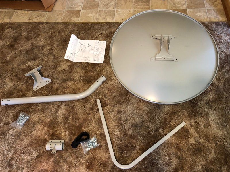

Dish arrived today. Looks a ton like my Geosat Pro 90cm, just slightly smaller. Got it put together quickly, now going outside to see if I can get 125 on it

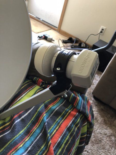

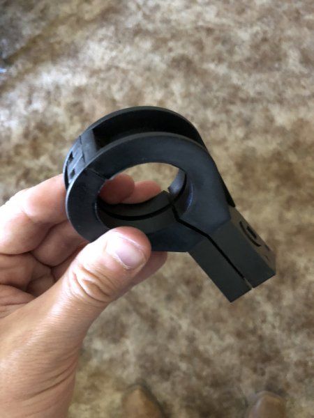

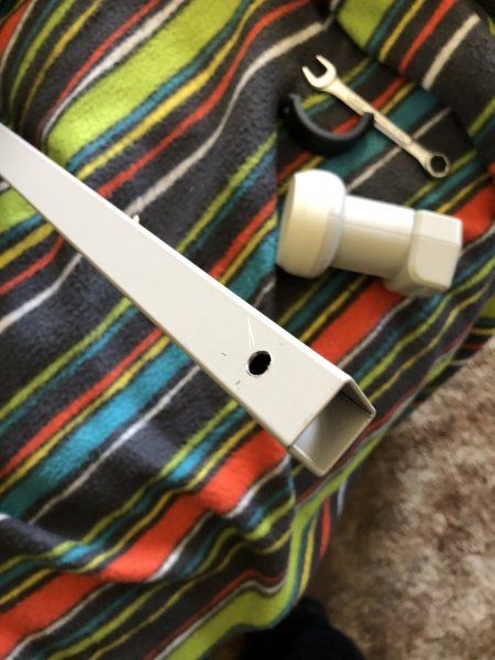

I didn't like the LNB bracket that came with the dish, so I drilled a hole in the top of the arm and put a GeoSat LNB bracket on the dish. The GeoSat bracket is numbered for easier skew, and allows for easier adjustment of the LNB

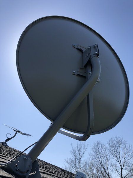

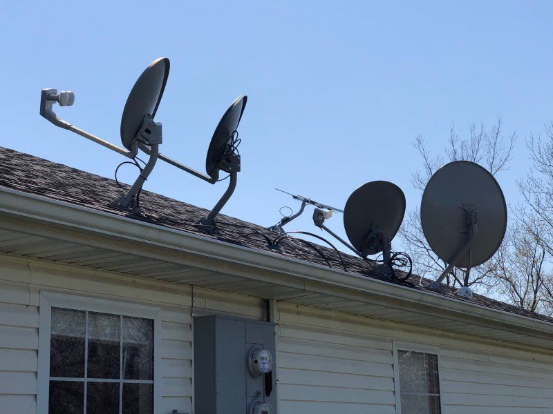

It was almost too easy finding 125. I was connecting coax, standing next to the dish (which I had just moved to an arbitrary location), and boom, it was locked on 125 already. The elevation is so low that the arm almost touches the mast. I can't imagine how I could ever receive any satellites west of 125, because they are so low on the horizon. As far as Dish Network installs go at this location, it's a toss-up between Eastern Arc and Western Arc. Both Dish Network dishes on my roof are Eastern Arc. DirecTV is what it is (see photo; they have one dish up on the roof with a D2Lite box in our maintenance room).

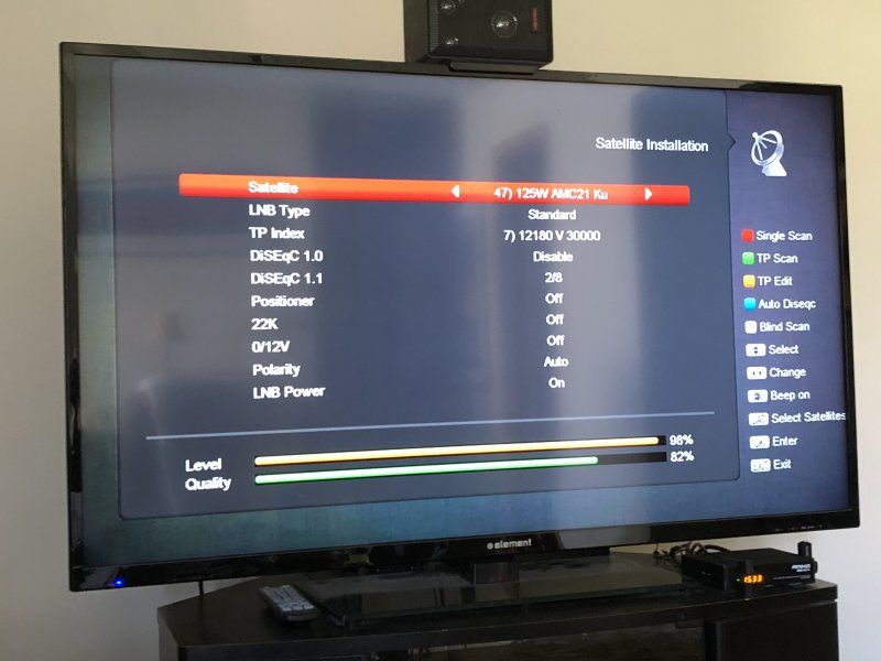

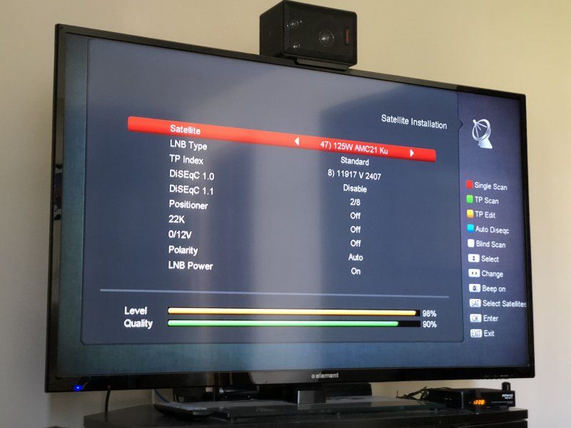

Happy to report that the 75cm roof dish for 121 and 125 has been working flawlessly for the past week. Signal quality on 125 is consistently 90%
Signal on Velocity is high 40's-middle 50's, while the other TP's on 121 are high 70's. I had my doubts about this smaller dish but it's exceeded expectations. And for only $83 and free shipping.

I find that the PBS feeds require the dish to be dead-on. I fine-tuned it this afternoon after the temperatures outside reached the mid-80's.
When I first set up the dish, it was cold outside and I was also using a GeoSat LNB holder instead of the one that came with the dish. As outside temperatures warmed, afternoon signal quality began to suffer. Installing the original LNB holder and peaking the dish today fixed the signal issues.
