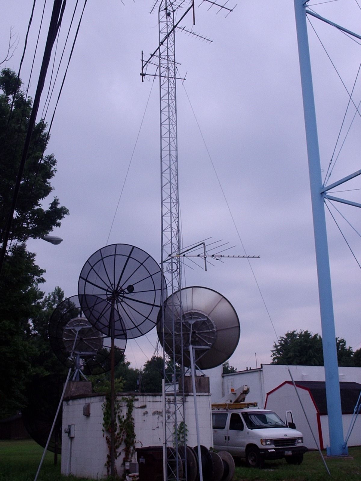

Don't think this will help you much but this is how I have 2 dish's mounted on the roof of my headend. Flat roof but the dish's are on a concrete block about 3'x3' square and bolted to studs that are in the concrete. You can also see the single dish on the 15' pole attached to the side of the building.

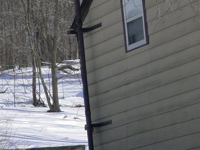

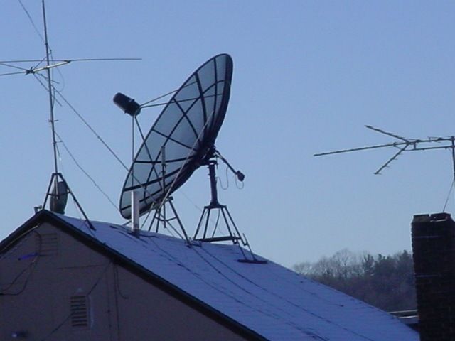

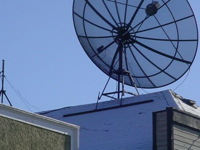

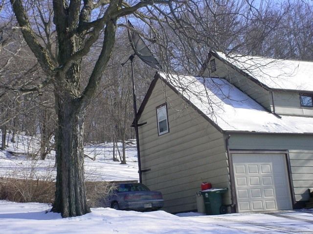

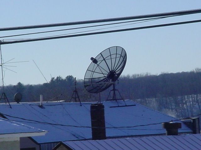

I've posted pics. of two different setups, the first being a 10-footer on a 30' piece of well pipe. I did this one in 1990 at my old house.
The second is mounted to a peaked roof using a tri-pod style mount and two long pieces of angle iron that first get bolted to the roof, then the tri-pod mount sits on top of the angle iron. This too is a 10' dish. The mount must be secure, as it's been there for just under 20 years.
