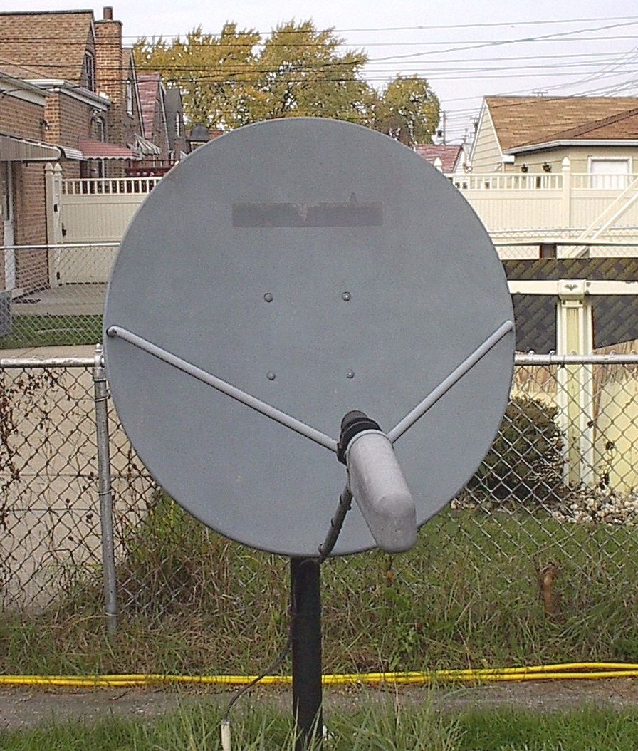

Changing the polarity on the dish should not make a difference unless your polarity was off to start with. Polarity H or V just don't change on the downlink antenna on the satellite by itself. So I suggest to most at this point to leave it alone if you had RTV peaked before hand or if you must mess with it to mark the exact spot you have it so you can put it back if need be.
I can walk up to my 90cm, setup and play with the polarity in about 5 minutes so if for some freaky reason with RTV I do need to mess with it it's a piece of cake.
