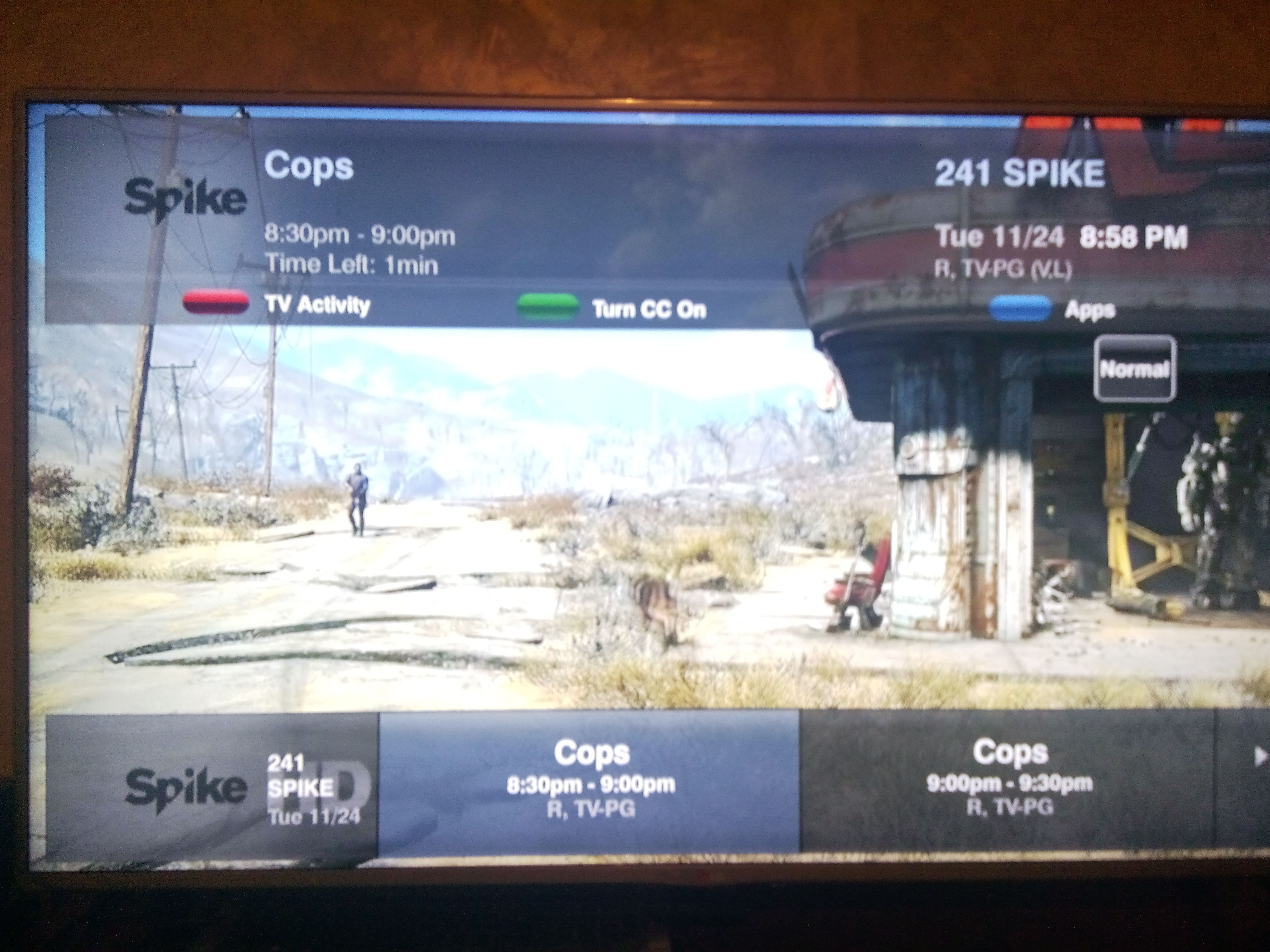

I just upgraded to dish hopper on saturday and I have the 528 version. While the guide and setup menus still has the old UI, I noticed the top and bottom bar in the live TV screens has a flat design got a carbon UI look. I don't know whether this was there earlier or it is part of the current release.
