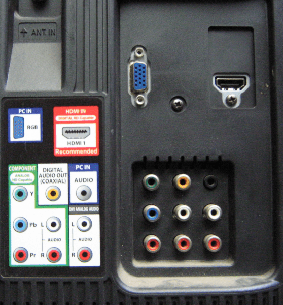

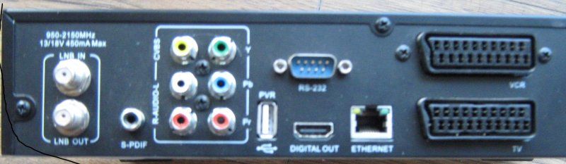

My TV is a Emerson Digital and has only a DMI input and attached are pics of the rear panels.
