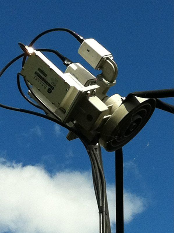

10' sami with ortho feed.
behind the sami is my recent addition. a 10' channel master. the channel master is c band only for the moment. i would like to have another ortho feed horn.
i may get a cheap dmx 741 or bsc 621 even though i am not impressed with ku on the lnbfs after using an ortho or corotor

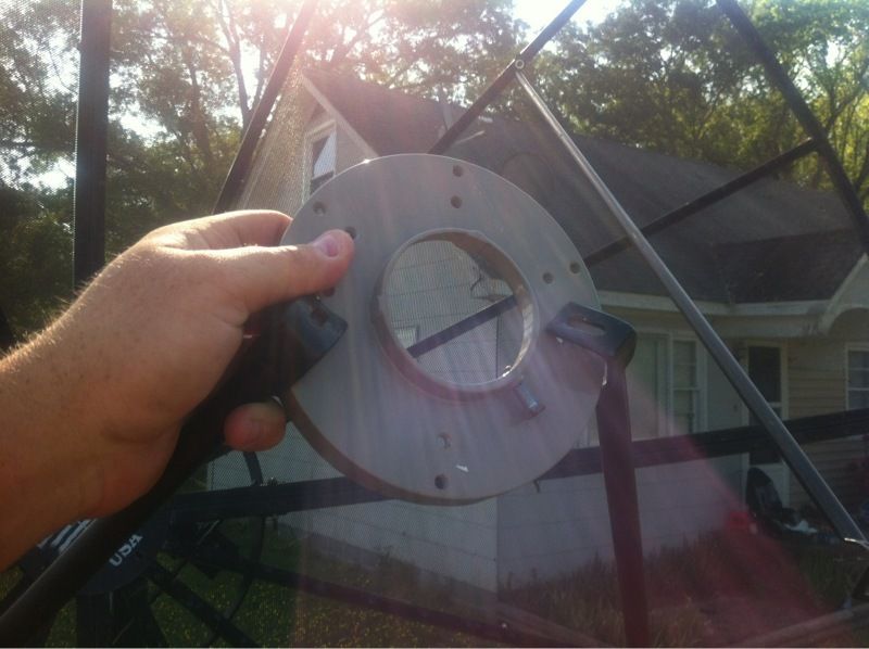

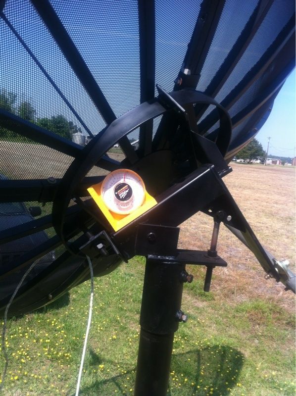

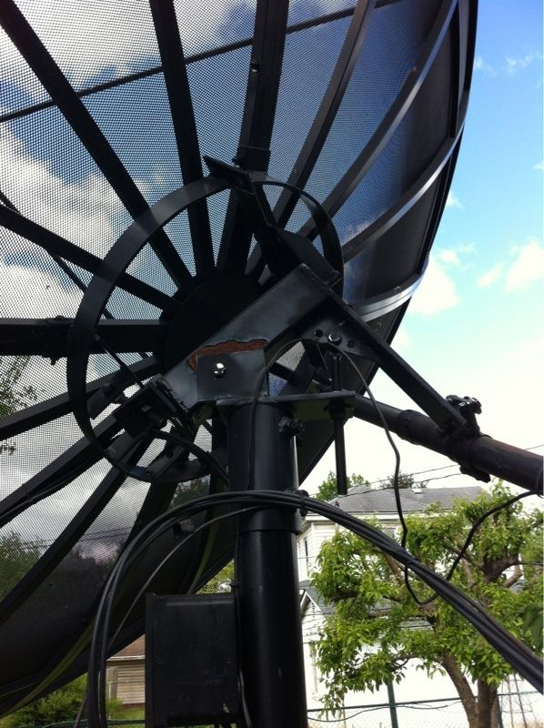

I figured out where they go but how does the scaler and feedhorn attach. Any good up close pics of it

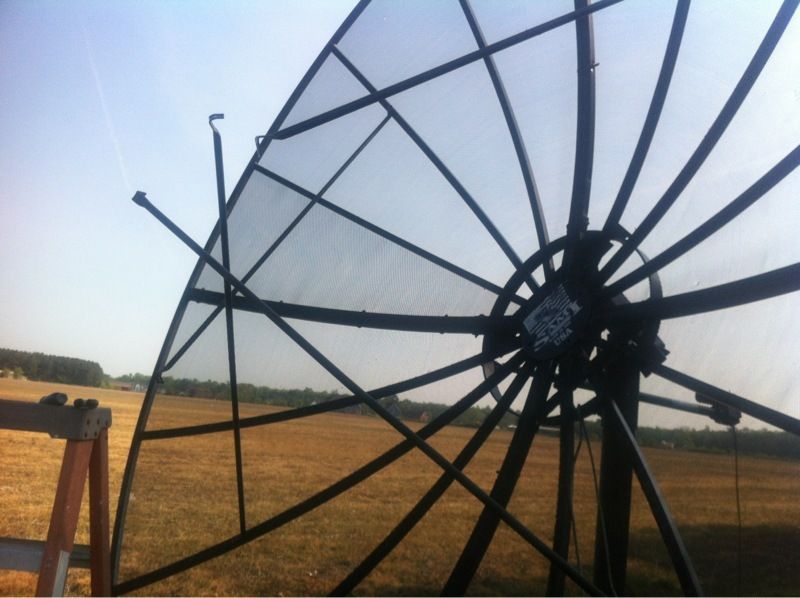

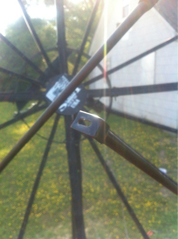

Here is some pics. I can't for the life of me figure out how to attach this scaler ring. It's like it doesn't want to line up right. If someone could post a good pic of theirs I'd appreciate it

just have to straighten out the arms there at the scalar. bolt it up, then measure from the scalar to the center of the dish to see if it's ~at your focal length. The feed should protrude a quarter to a half inch or so for the F/D. If that's OK, give it a go.
What I mean is the ends do they mount on the top or bottom? I can't get them to bolt up right cause they don't want to sit flat on the scaler
Top. Use large pliers to bend them flat to align nicely on the top of the scaler. But keep the focal length in mind as was mentioned. Otherwise readjust the struts to get it right.
Ok got it bolted finally lol, didn't know if I bent them if it would mess something up. So now how do I got measure to see if it's lined up correct. I didn't have this problem with the little dish, lol or the ladder!
here is what i did:
1. measure from the edge of the dish rim to the edge of the scalar ring. center the scalar ring with the bolts slightly loose until all three measurements are equal. lets say you end up with 64 inches from the edge of the scalar to the top, side and bottom of the dish.

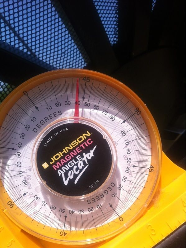

2. now to make sure the scalar is aimed at the center. i used an angle finder and compared the degrees from the center metal plate on the dish to the front of the scalar ring. that will get you real close.
the number of degrees do not matter just make your numbers match. again, you may have to do a little bending and manipulation of the flattened feedhorn strut ends.
