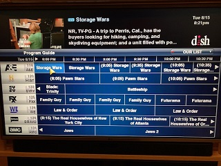

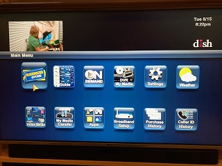

The 922 menu system, guide and interface is similar to the newer receivers, see for yourself:
Plus the way it records into specific folders rather then just putting everything in one menu also makes it much easier to record and file your favorites.
