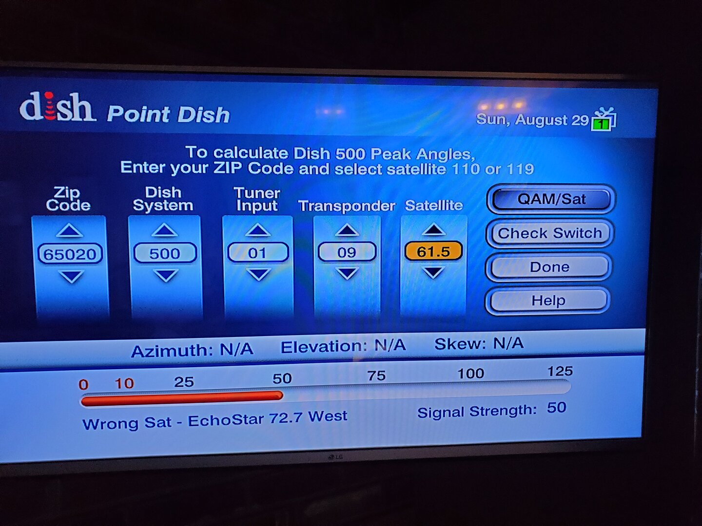

I was recently getting satellites 72 and 77. Since I wasn't getting any HD channels I decided to switch to 61.5 and 72. I can get 50 percent on the 61.5 signal bar on the point dish screen but the bar is red and it says wrong satellite. The satellite 72 is about 45 percent and green and I can get those channels. Not sure why I'm getting a signal on 61.5, but can't get the channels? Thanks

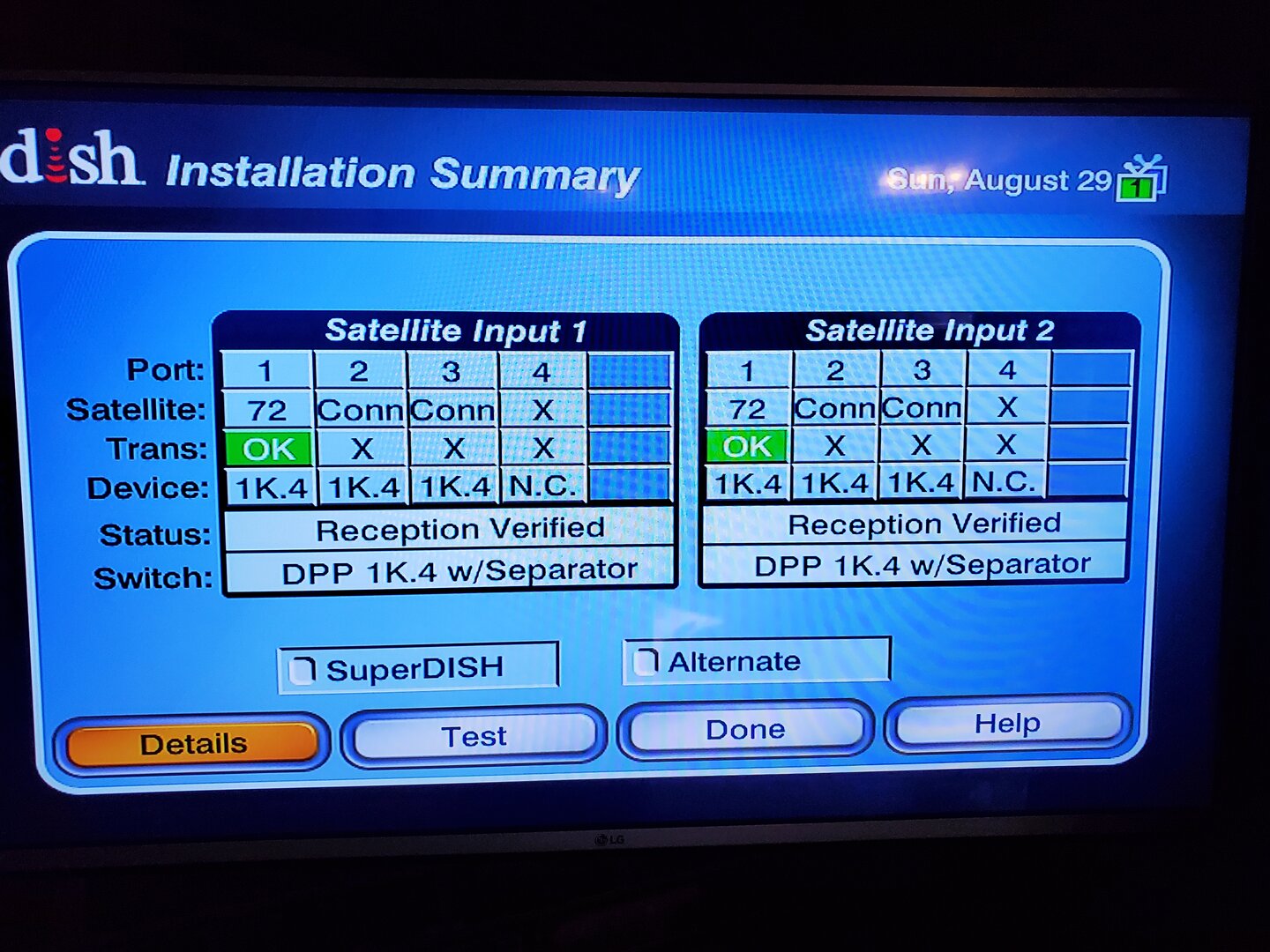

Here is a picture of my set up screens. I read in another post to unhook the dish then do a test switch to clear everything out. Will that help or not?

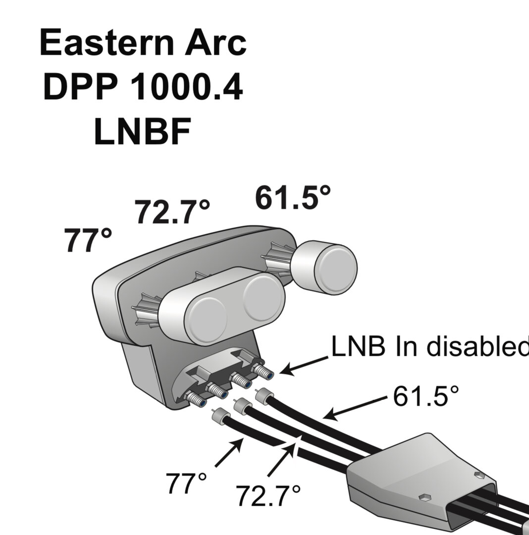

I had one of those for years on my 722 and received all 3 sats without issue. As Hipkat said, this LNB already receives 61.5 (and 72 and 77) if healthy and aimed correctly. If you moved your dish, to the east, it is unlikely that you will receive just 61.5 and 72 because the spacing on the 72/77 feedhorns is too close.

Port 1 should be 77, and 2 72.7. If you are getting those two in that order, and unless you have a defective LNB, your skew is wrong. 72/77 are so close together that having somewhat of a poor skew will allow it to work, but 61.5 is on the far end of the LNB and a lot more sensitive to skew. What's your zip?

Does it say that after checking switch or are you going off of the point dish screen? Does it list 61.5 as a valid sat on both inputs? Can you post a picture of the check switch screen showing 77/72?
Its saying that after I run the check switch, then go to the signal screen and its red. When I first check the signal sttength it's green for a few seconds then turns red on 61.5. 72 stays green the whole time. Is there a way to test the lnbf to see if it's bad?
Here is the thing. If the installation summary (first picture you posted) does not list 61.5 after running a check switch, you don't have reception of it, period. It doing that on the point dish screen means that it looked on the port it expects 61.5 to come from (port 3) and didn't find something, which makes it default to another LNB (in your case, 72.7). Once the receiver realizes that 72.7 is being received when 61.5 was asked for, that is when the receiver changes the bar to red to let you know something is wrong. This takes a few seconds.
You need to keep adjusting skew until running check switch lists all 3 sats on install summary, because until then what you get on point dish is inaccurate.
