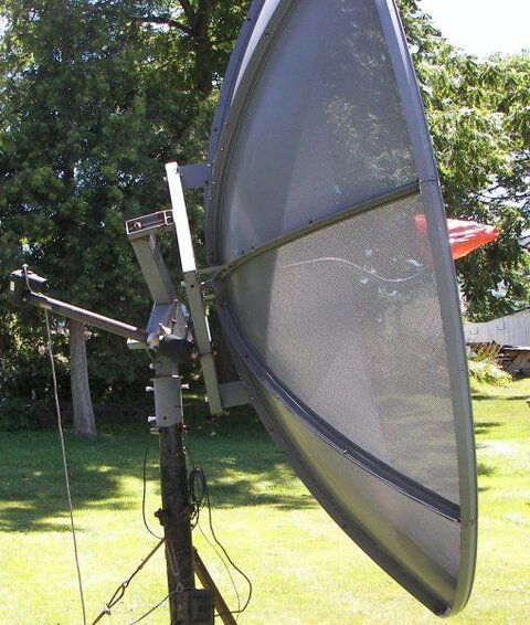

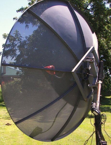

Here's how I have mine on my Pinnacle;
Thanks waylew
From the end of the outer tube to the clamp how far is it, hard to tell from these pictures.
Let me know.
Regards.
Tunder
Don't know,never measured it,probably around an inch.Just enough room to clamp the boot on to the end of the tube.
Basically I just suck the actuator all the way in and set the dish to just at or a little below the horizon.
Since you are on the west coast put the actuator on the east side of the dish. With the actuator tube fully retracted loosen the actuator clamp and move the dish letting the actuator slip through the clamp until the dish is pointed just below your eastern most satellite. Tighten the clamp and reprogram your DiSEqC box :)
