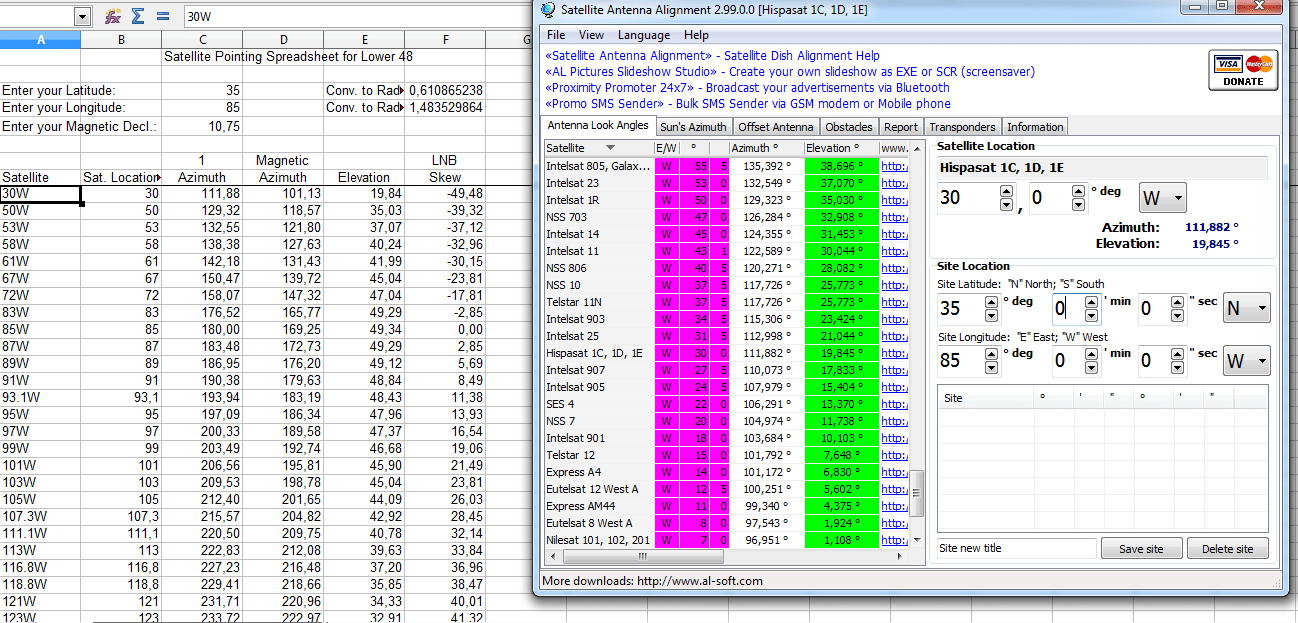

bpalone Good job! How it is possible to enter Eastern arc satellites? I used to use Satellite Antenna Alignment (SAA) program for calculations. It also works without internet, but should be installed locally.
On screenshot you can see that your spreadsheet and SAA make same calculations. upload_2016-1-26_18-35-51.png

RimaNTSS : Adding Eastern satellites shoudn't be difficult. Have you tried negative numbers?

RimmaNTSS and A33,
On the first page of the geosynch.pdf note the asterisk (*) at the end of the definition of "L". The only asterisk I found was at the bottom of that page under the first column. That might apply to Eastern satellites, didn't check, as I was scratching my own itch, which is Western arc.
