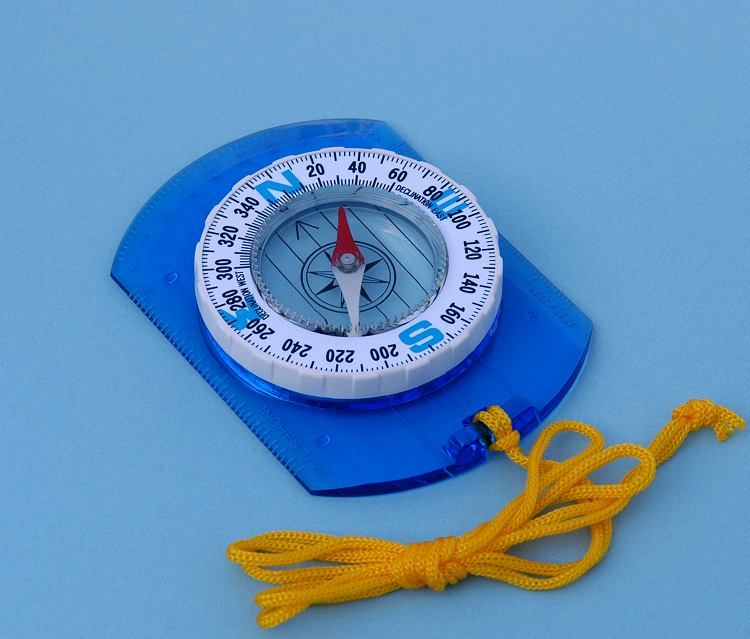

Make sure you don't get JUST a plain compass but a mapping/heading compass with a rotating bezel. About $12 - $19 at a Wal-Mart or cheaper online depending on wait time and shipping if any: http://www.brasscompass.com/mapcompass.htm
