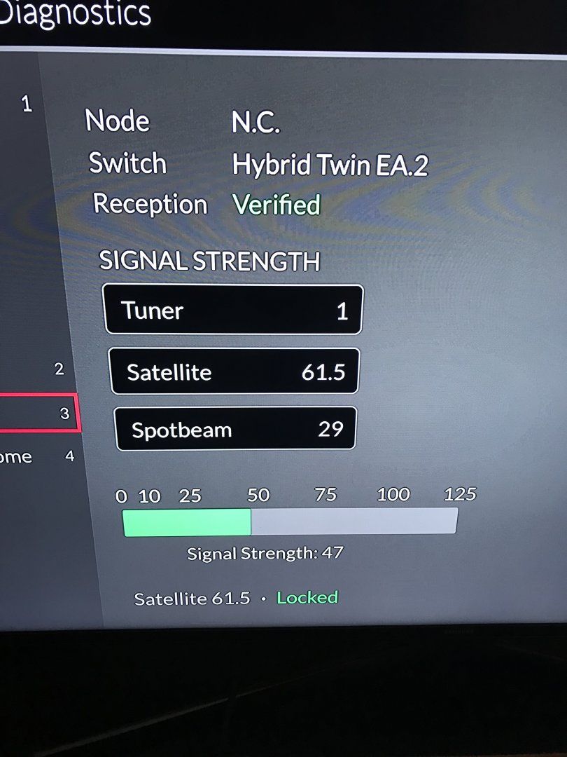

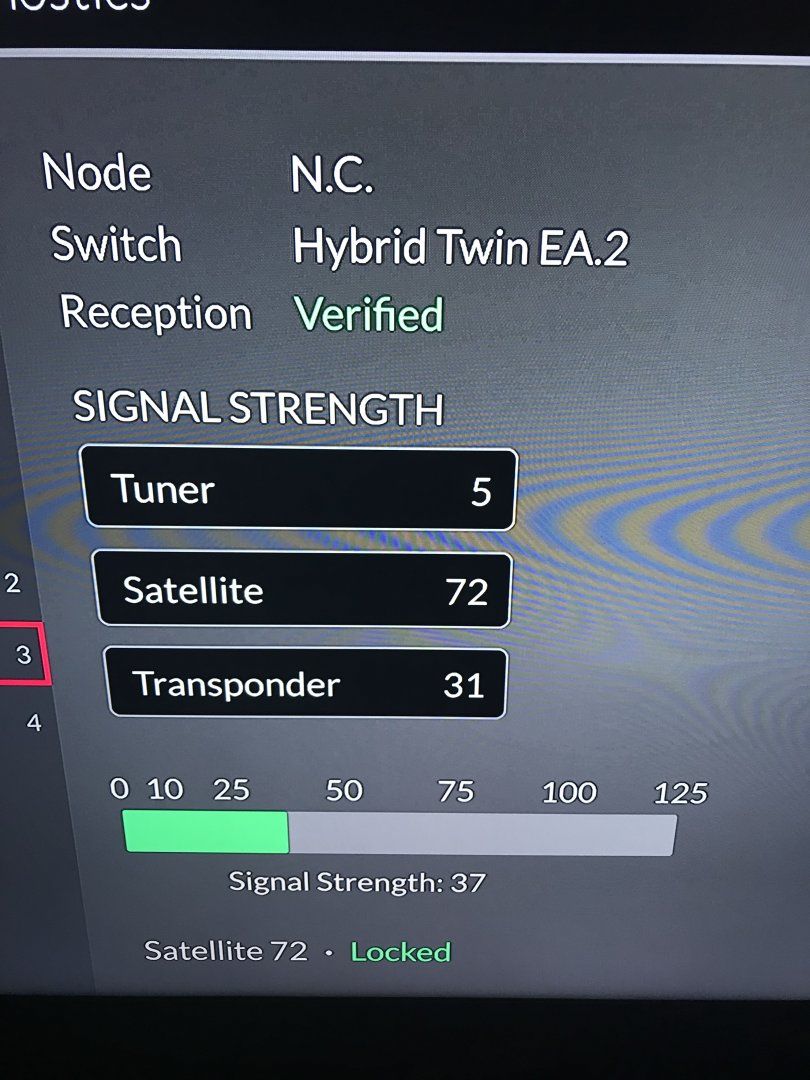

This is what I get...anything I can do?

Your problem isn't the signal level. Are there any tree branches, bushes, etc., that might intermittently interfere with the signal when the wind blows?

I find it hard to believe that a signal at 47 or 37 is not low or wouldn’t affect the quality of the picture. When it is this low the picture is so blurry and fuzzy. Dish claims both are good signals and only 20 is low and 37 or 47 range would not affect the quality of picture. Unbelievable if you ask me.
A digital signal is either good or bad. There's no snow and the pixels are either on or off with nothing in between. A low signal level that's still above the "no signal" threshold should display the same picture sharpness as the strongest signal. The lower signal will however, be subject to more rain fade, etc., than the stronger signal. Pixelation occurs when the signal is briefly interrupted and data bits are lost beyond the capability of the automatic correction system to compensate for them.
