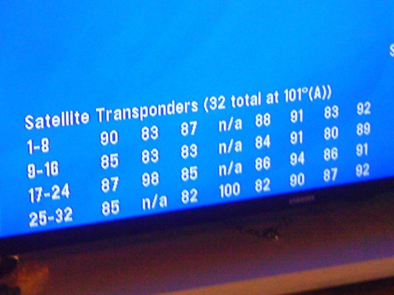

I bought a new LNB after pointing the dish to where the Directv screenshot said but I had to go to DishPointer.com to get additional numbers as to the Elevation, Azimuth, and Tilt. It turned out that the Tilt, -23.8° worked whereas the Tilt, 101.9°, given by the screenshot didn't. It worked at 101.9° for years. I tried the two older LNBs and they also picked up she signals. So, egg on my face. It took several hours of going up and down the ladder. I've got the two older LNBs on Craigslist and maybe I'll recoup my expense. In the meantime, the center wire in one cable broke but I had a spare including a Coax F-Connector. I need to get a F-Type adapter to connect the new cable. Now I'm using a signal splitter.

You've got your numbers mixed up, but thats ok, seeing you got it working ...
That said, your numbers are just OK for thre 101 Sat
What are the readings for the rest ?
The numbers for the 110° and 119° are N/A. I don't want to press my luck and fool around on the roof trying to make the exact, precise setting. I was able to get the local programming by doing a Reset Everything and making sure I did the Primary and Secondary locations. I used two nearby online of sight zip codes. So far I'm getting want I want. How much better should they be?
101 numbers should mostly be in the mid to upper 90s. In your area they tend to be lower, more like upper 80s to lower 90s.
