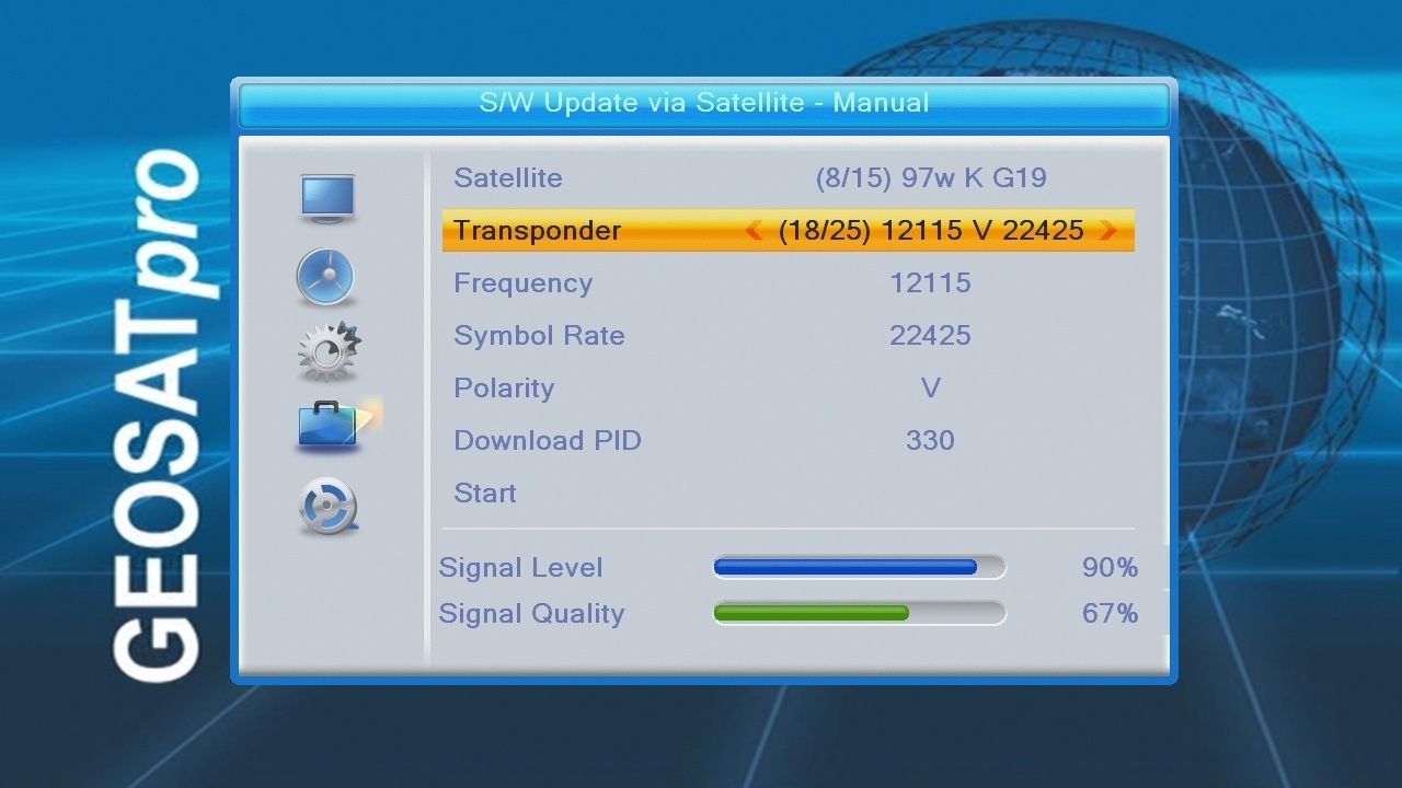

Highlight S/W Update via Satellite - Manual, press OK

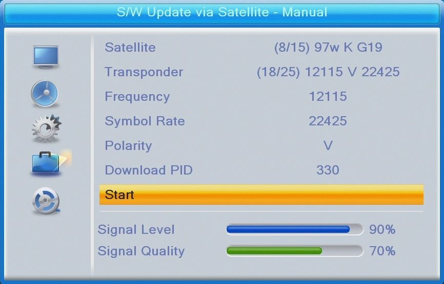

Highlight Transponder and press the Right arrow key to select frequency 12115 V 22425
Do not change any other settings in this menu.
Verify that the Signal Quality is 50% or better
Highlight Start, press OK key

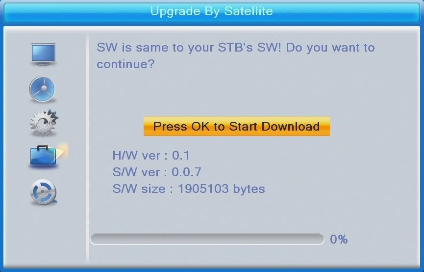

STB will collect Update File information (allow up to 30 seconds)
This file may be the same as your current version, but you may download.

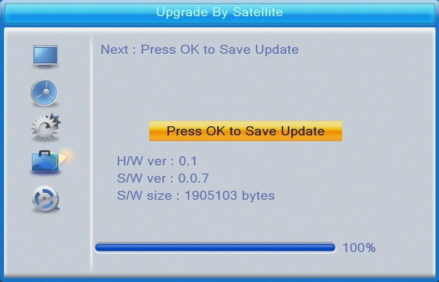

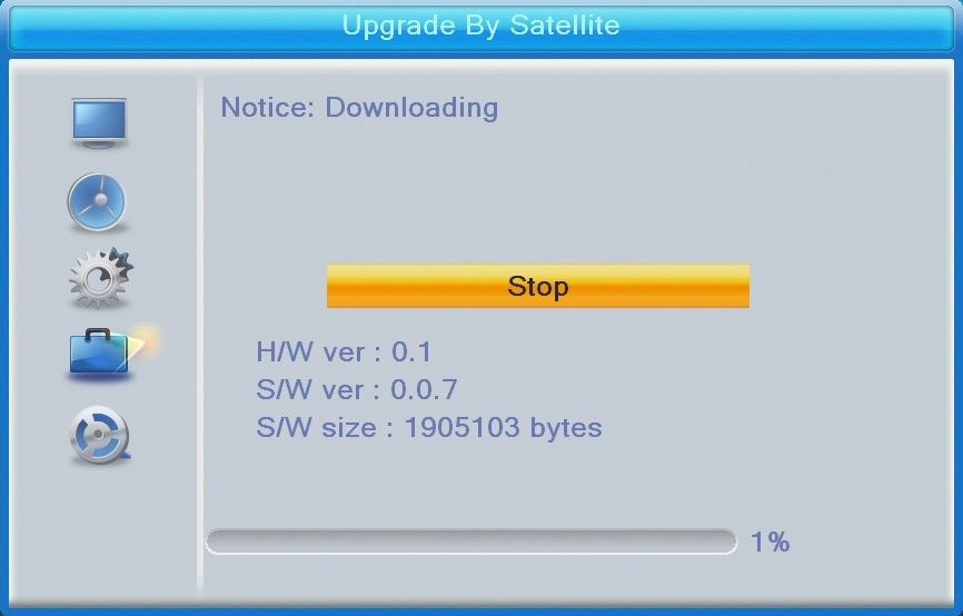

Press OK key to start the download.
The download may take up to 2 minutes to complete. A status bar will show progress. If data is incomplete on the first pass, a second pass may be required to complete the file. You may stop the download by pressing OK key

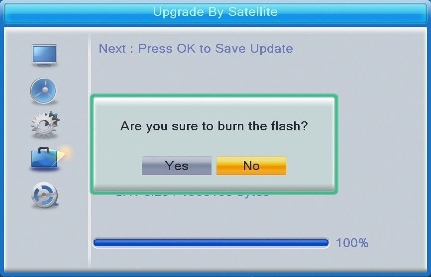

When download is 100% complete, the prompt will appear "Press OK to Save Update"
Press OK key if you wish to save and continue

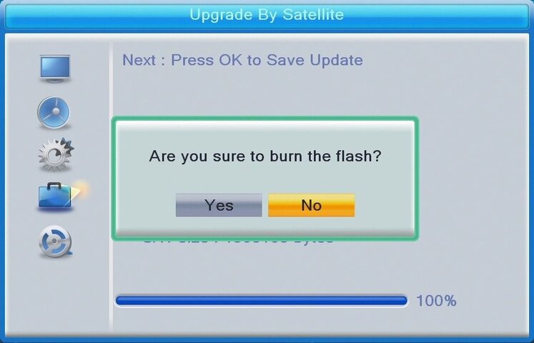

"Are you sure to burn the flash?" will appear. This is your last opportunity to exit the process without updating the firmware.
If you wish to continue, press the OK key. Do not interrupt or power down the STB during the part of the process.

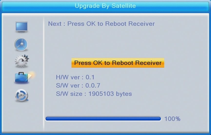

The final step of the process is to restart or reboot the microHD. Press OK to Reboot the Receiver.
The receiver will power off then restart.
The update is now complete!

just tried it and worked pretty slick
noticed it downloads really fast to 98% then takes a while to reach 100%

I also upgraded to the latest version 6/15/2012 and used the Manual Satellite Update to download the 5/23/2012 version.
It took three and a half minutes to update from the time I selected "Press OK to Start Download".

some receivers may not have 12115 V 22425 in their receivers already so if you have one like mine that did not have this frequency listed you have to manually enter this for Galaxy 19.
Then do as Brian posted here.

Worked really good and as Ice said it goes to 98% quickly then it takes a few minutes to finish and when done a box appears on the screen letting you know it has finished.
Very simple and easy way to upgrade the firmware.
