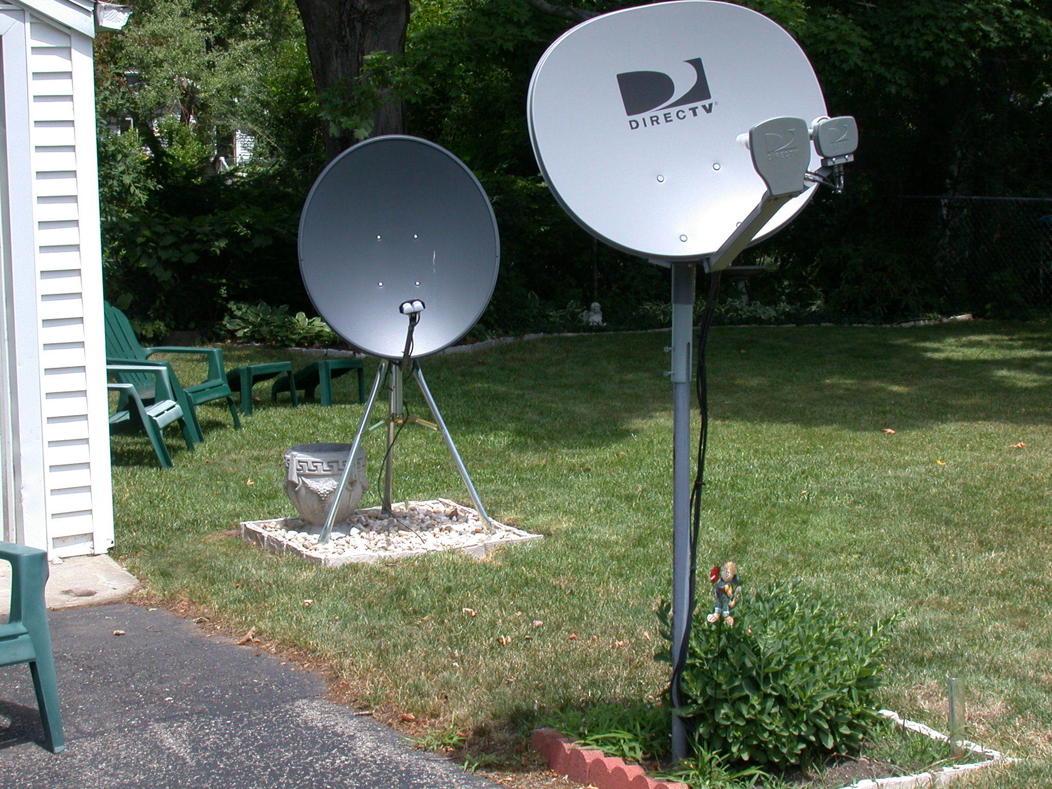

Is there any way you can do a pole & concrete out by what looks like the pool area?
Yes, but it would look really bad. If I'm gonna do that I might as well hide it on barn slightly more distance but still. Granted a line from the pool would be a lot easier to bury but still. A pole would work a bunch of other places and it would be a hidden pole (like in brush, behind buildings....by the basketball court aka next to the garage).
I've seen them on poles but D* installers were hesitant about it...no clue why.
I couldn't tell if there was an area there that would allow you to "hide" the dish or not.
Yeah...see....I think D* is just paranoided, there are enough breaks in the trees. If there a way they can check signal strength without a dish. Like a line of sight computer thing?
You can guestimate using a compass and an inclinometer, but without putting a dish on a tripod and hooking it to a TV or signal meter, there is really no way.
The installers are cautious about this install because if a tree blocks your signal during the warranty period, they have to come back out for NO PAY and try and fix it.
Poles look great (IMO anyway). Must better then on a roof. Here is a pick of my DirecTV dish on an old fense post and behind that is my FTA dish on a tripod. I need to get a more recent pick though since my wife planted the flowers in the pot and around the DirecTV dish. Looks great. Use it as an excuse to landscape. ;)
