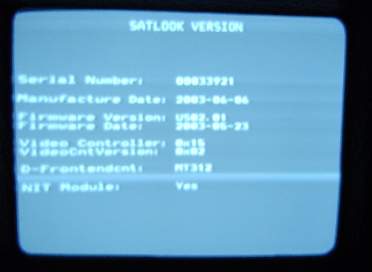

I recently acquired a new/used Satlook Digital NIT Meter/Analyzer. As you can see below, it is almost 5 years old.
The previous owner had bought it for one job, and after that put it on the shelf and was never used again. I know that to be true, because the cables were still sealed in the original bags.

Here is a picture of the Date.
