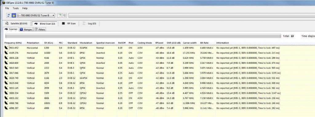

I am unable to see 61w due to the roof line blocking line of sight, but am able to see 83w.
83w has many occasional use and on demand ACM (Adaptive Coding and Modulation) services. Most STBs on the market only receive CCM (Constant Coding and Modulation) signal types. While these CCM capable receivers will identify an ACM carrier and log it as a CCM type, the FEC on a ACM service may shift and the previously logged transponder is no longer able to be decoded and will not show a lock as the receiver is not adaptive.
I have attached a screenshot of the services that were active a few minutes ago on 83w. If I scan again in a few minutes, there will be other ACM carriers lit-up.
