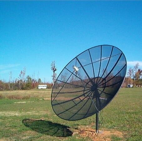

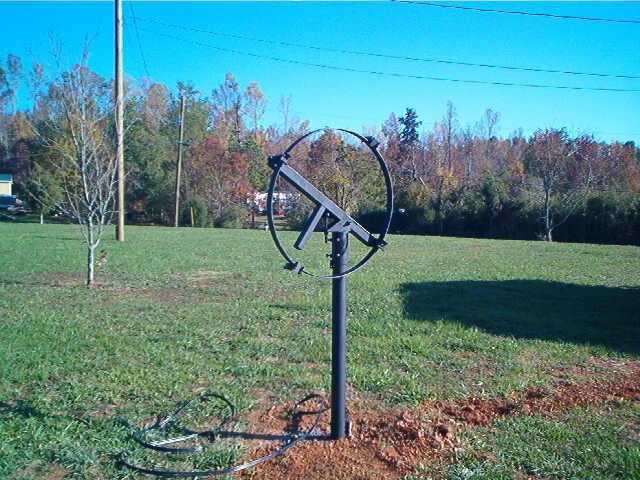

Scanning the sky's with c-band again thanks to a friend and fellow member here
(GIJoe) who give me a 10 ft dish after mind was blown away by a tornado backin
April. thanks again Joe.

i got a strange problem that i cannot figure out. i get a 80 to 100% signal from 137 all the way back to 87 but i cannot get a thing on 83 are 72. i noticed the signal on the v side is a lot lower then the h side only 30 to 50 %. i am using a Geosat pro c2 and have adjusted it for best signal just cannot figure out why i cannot get any thing on 72 any one got a idea what it may be. thanks

I see you're in Georgia, and getting the western sats quite well, but not the eastern ones.
This makes me think that your polar alignment might be off a bit, or your pole may have
come away from plumb with the weight of the dish on it?

i checked pole it is plumb i have also adjusted dish and lnb to the best signal. 72 has a couple of hot feeds one is a cw network but it is s2.
