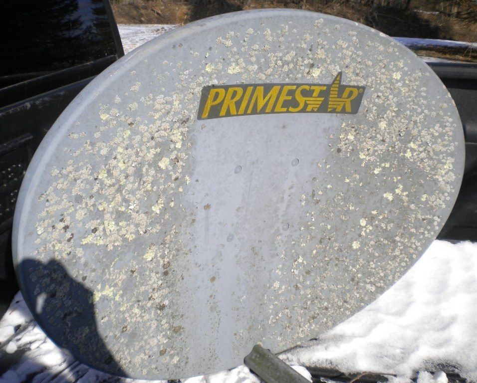

I was driving to get something in the very northern tip of Virginia and spotted this PrimeStar plus a BUD.
Stopped and asked about both - - - they said take the PrimeStar but they would have to check about the Big Dish.

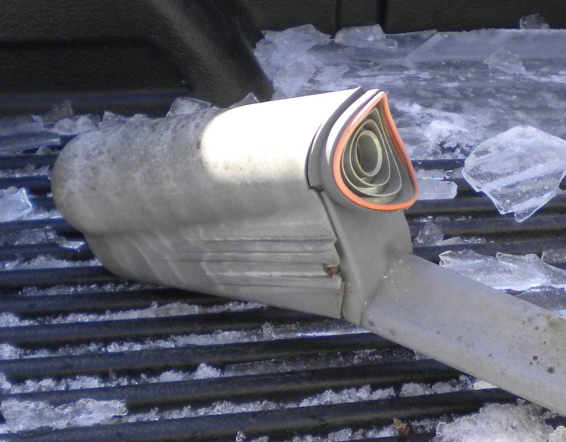

I love the looks of this thing - - - it has barnicles and mold on it. Still got the PrimeStar label. Measures 35 1/2 X 26 1/2 No cover on the LNB but that should be easy enough to fix.

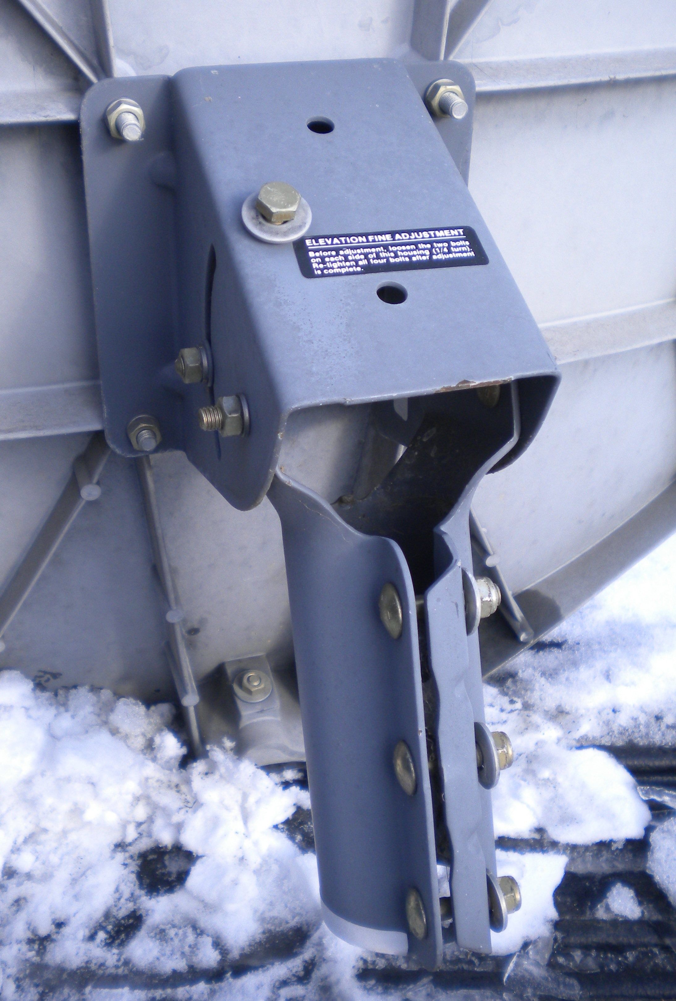

Thinking of replacing my DirecPC dish that I have motorized and making this larger dish the motorized one.
I guess for best receiption I should leave the barnicles on. :p

very nice :)

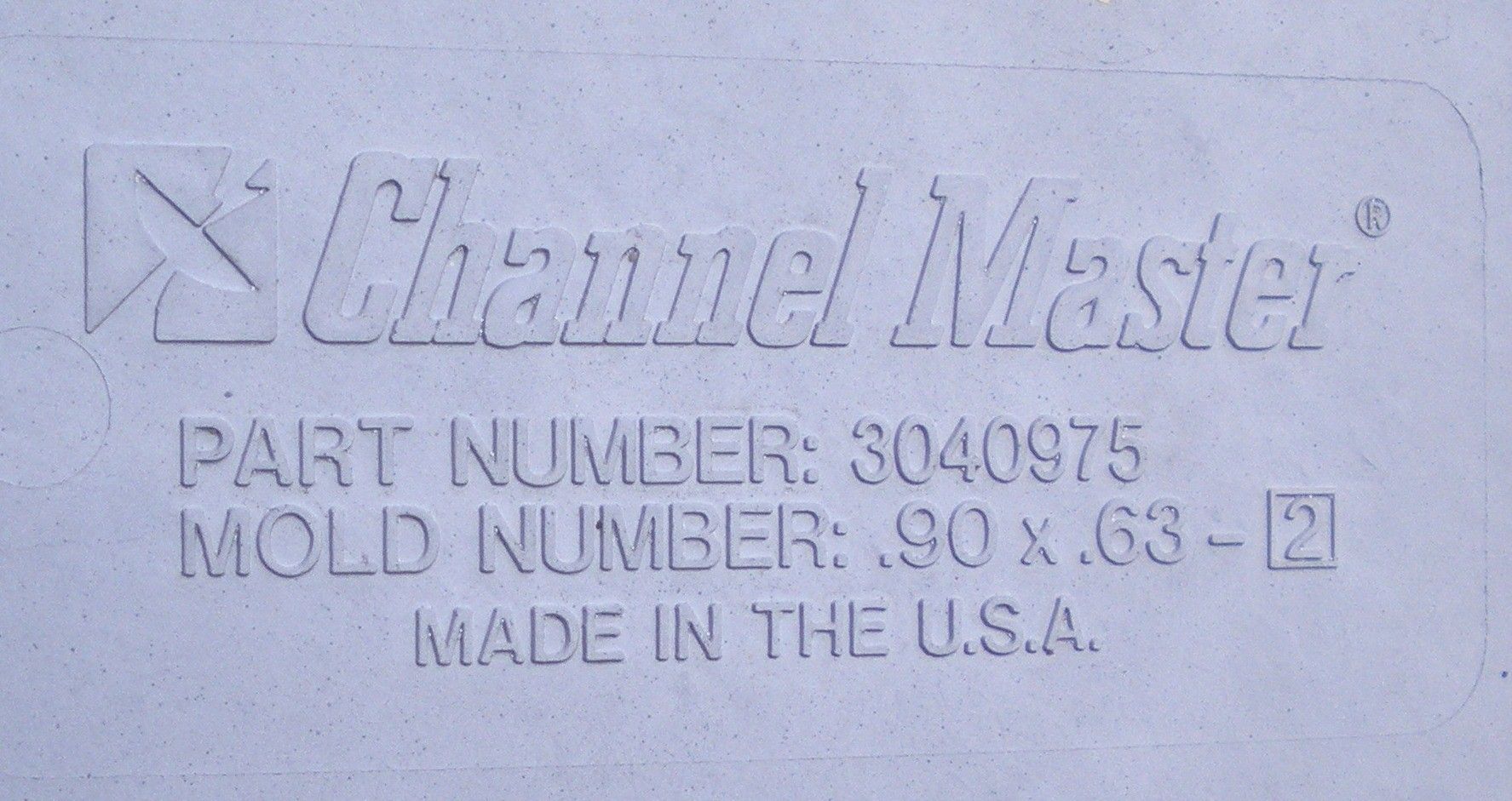

You might want to clean the dish but otherwise it will work great. Its the 75e model which is 37x27.
congrats on the find :)
Very nice, 'n good price, too!
Wonder how one of those plastic pot-scrubbers would work?
The ones that sort of look like 1/8 or 1/4 inch open loops?
Not the Scotch-Brite - those are reserved for more serious problems and they scratch metal!
But the plastic loops are safe on Teflon pots, so I don't think they'd hurt the dish.
Of course, if you come up with something to sponge on that'll remove your crud without elbow grease, do tell. - :up

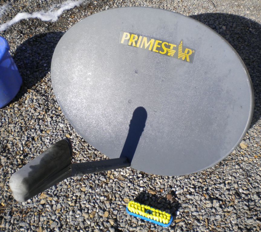

The dish of course was not covered with barnicles but lichen.
I used a soft brush like you use to clean hub caps with some soap and hot water. Took a good half hour to clean it off.
Here is the after picture.

The stock LNBF will work fine. A lot of the P* LNBFs have separate H and V outputs, if yours is like that you will need a switch to combine the polarities on a single coax to your receiver.

I looked at many pictures today of the 75E - Primestar dish.

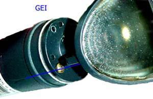

One of my other dishes is a DirecPC which is slightly smaller and has the Hughes LNB as shown. Notice it has a clear piece of plastic over the front of the LNB.
I notice on my LNB which has both V and H connections it has NO clear plastic piece over the LNB. (See picture).
Is it supposed to have a cover - - - or did it when it was new?
