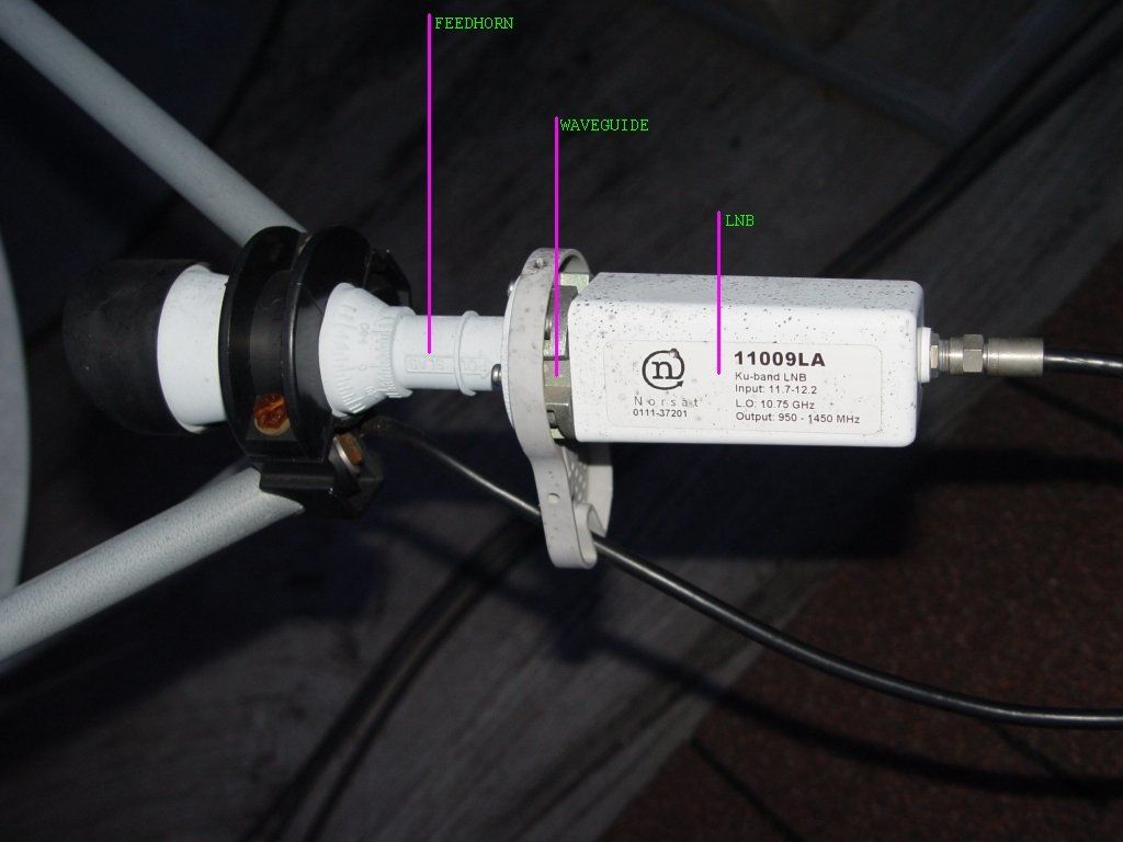

You will probably want to replace the Norsat, here's why: This is a single polarity setup, so the Norsat will only be able to get one polarity (either H or V, depending on how you twist the feedhorn). If you remove the Norsat LNB and attached waveguide (see attached picture), you will be left with the C-120-flanged feedhorn. You can mount any C-120-flanged LNB to the feedhorn directly. The Invacom QPF will work, but a far cheaper solution would be either a Hughes DirecWay LNB or the bandstacked FSS LNB from a Dish Network Superdish.

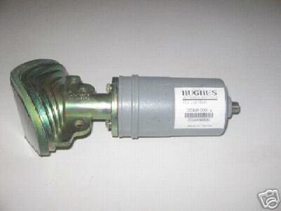

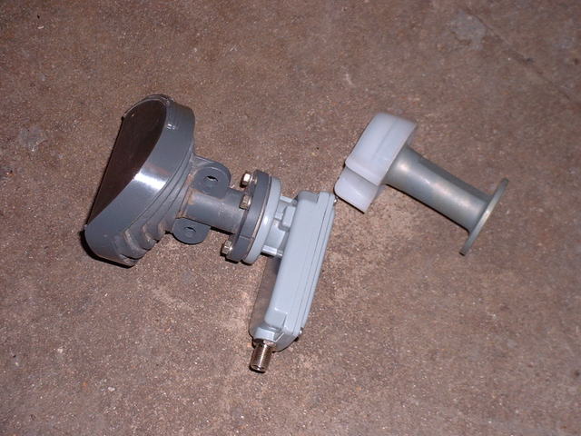

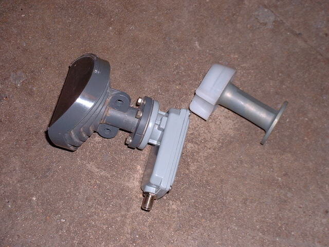

Turbo, I replaced the original single polarity LNB on my CM dish with a Hughes C120. When I first installed it with the wave guide in place it didn't seem to work very well, although it did get both polarities. I then measured the the distance to the pin inside both LNBs and determined that with the waveguide the focal distance was not the same as without it, as compared to the stock LNB, so I installed the new one without the waveguide in place and it improved things immensely.

That little piece of waveguide is an impedance transformer to adapt the round waveguide of the C120 flange to the rectangular waveguide of the WR75 flange...has nothing to do with polarity, as the LNB only has a single probe for a single polarity.
Thanks for straightening me out on that one Tron! I wonder=does having that waveguide on it make it into a single polarity? If so, looks like you could just remove it (?) I haven't lucked onto one of those setups to study yet.
The Norsat is single polarity only. As ACRadio said, you have to remove the waveguide to attach a C-120-flanged LNB.
