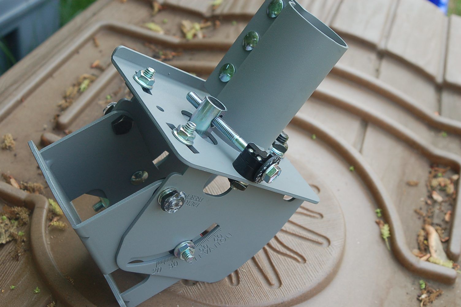

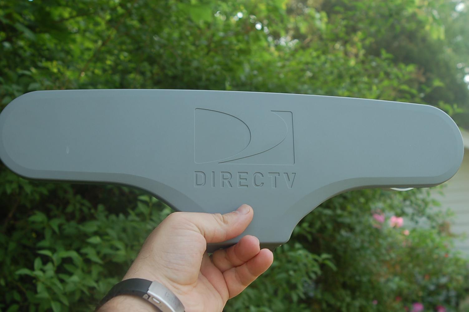

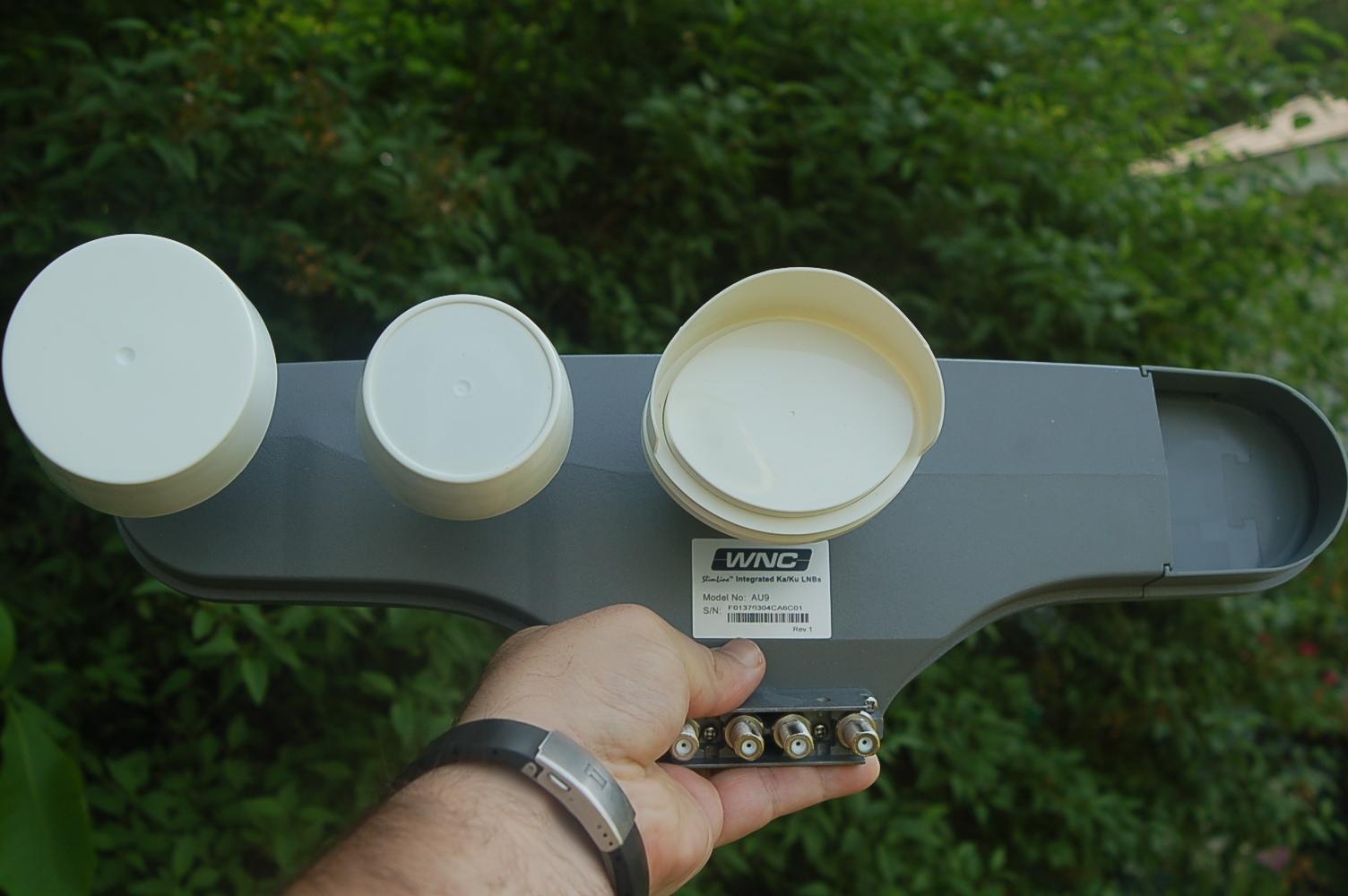

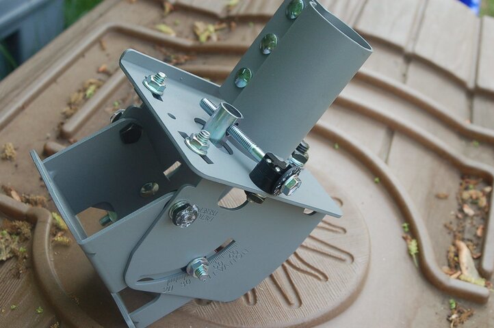

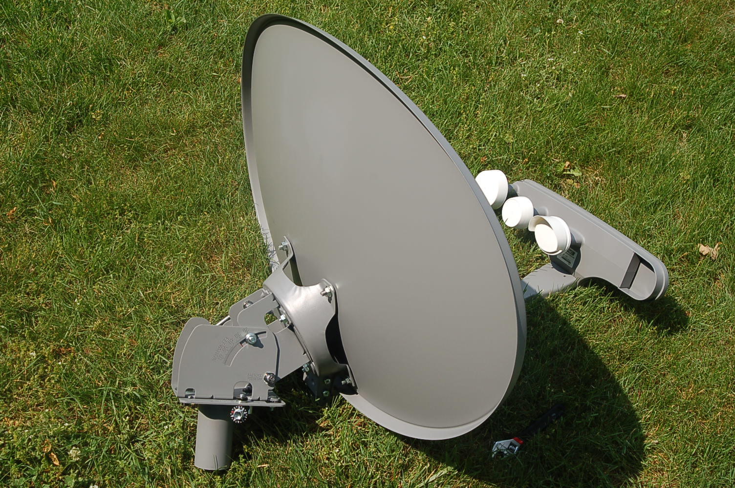

So I woke up late today (it felt good to sleep in) :) and then got dressed and headed outside to put together the dish.
I got all the parts out of the box then jumped into it.
Surprisingly assembly of the Dish was EASY, I had the complete Dish put together in around 15 minutes, which I don't think is bad considering I have never put one of these together.
I hooked the Dish to my METER and held it in the air and immediately got signal. :) Let's hope its that easy when I mount it. :)
Missing from the install was lag bolts so that I could screw the mount to the house, so I will need to head to Lowes to get some.
Here are some pictures of the Dish. (And one of my dog... Flash. :D)

Well the Dish is in. :)
It took a little longer then I expected as I took down and moved my Dish 500 and put the Slimline dish where the Dish 500 use to be.
I also had to jury rig the DirecTV Dish as the mount was bigger and I have aluminum siding so the bottom foot was not touching anything. So I had to cut soome wood and use it to support the bottom foot. Then I drilled through it and tightened everythng down so it was plum and level. And put the Dish on the pole and I was on 101!
While I was on 101 the signal was low, I checked 110 and 119 and the signals were in the 70's.
I then used the fine adjustement screws on the dish and got the signals on 101 in to the 80's to 90's from the mid 30's earlier. :) I checked the other satellites and the signal levels were all around the same range. I was happy and locked it down.
