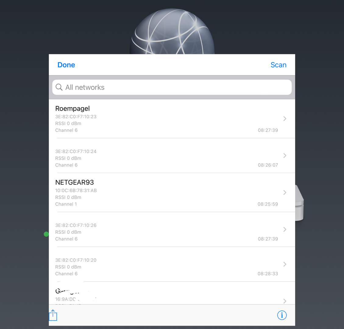

So, I think, I want to try this at home, as I have always seen some odd Wi-Fi networks in our home, in addition to the Wi-Fi I set up. I fire this up on my iPad and bingo, there are some normal names, like "NETGEAR93", but also some weird SSIDs like "kenganinja", "Starbase4", "Section9", to name a few. Here's the weird thing: the Signal Strength is 0 dBm, not -xx dBm like my home Wi-Fi SSIDs, or even weaker numbers for some other networks. It reminded me of the old thriller, "The call is coming from inside your house!"

It would be a bizarre side effect, and I wonder why it hadn't been reported before. I just took a quick look and these are the two SSIDs that show, plus some that have no visible SSID:
Now, what's interesting is "Roempagel" might seem like a random made up word, but it the name of a local Remodeling company. I wondered if what I was seeing was some "feature" of my Carrier using my iPhone as a mobile femtocell so other customers could attach to their Wi-Fi if we were in close proximity.
Maybe it's simply a nearby net that the phone happens to (barely) be able to "see" that the ipad didn't. Then because the phone saw it, it passed the info along to the tablet.
Notice that the MAC addresses of the SSID-free devices are all very, very similar (as if they might have nearly sequential serial numbers).
I see also that the Roempagel MAC address is in the middle of the same MAC address sequence. Very spooky indeed.
These MAC addresses aren't assigned to a manufacturer but may be of a "Locally Assigned Address" or "randomized MAC" type so they may be part of some scheme that is used to prevent tracking of mobile devices. Presumably all the devices would need to know about each other in some way to prevent MAC clashes.
