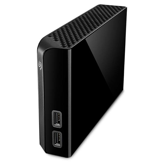

I bought a new Seagate 6TB desktop external hard drive. My Hopper 3 will not see it. Tried every port and rebooted. It works fine with my laptop.

This behavior is nuts! What model Seagate do you have? Mine is a Backup Plus Hub.
I think that's the one that had the problems with TheKrell
I think the hub part is not compatible. You need to get a non-powered hub (just search the board for 8TB 2 drives and you and see my setup complete with all the Amazon part numbers and pictures of how I have it set.
You may just want to relagate the current 6TB (unless you can return it) to something else and just get a 6TB WD MyBook or a raw 6TB drive with the Orinco enclosure that I put mine in.

It is indeed, but my problem wasn't with the Seagate itself. It only has a problem when I add my 1.5TB WD to the mix and then that smaller disk takes over. Since I don't really need that 1.5TB, this is not an issue. Both the Seagate (by itself) and the hub work reliably and have for months. I have my OTA adapter plugged into the front of the Seagate. Rock solid.

If you bought the Seagate expressly for the purpose of Dish EHD use, you can try “Cleaning” the partitions and Master Boot Record from the drive. WARNING: THIS WILL ERASE EVERYTHING OFF OF THE EHD AND IT WILL BE GONE!!!
If you have Windows 7, 8, or 10, you can fire up an Administrative Command or Powershell window, then type DISKPART. At the DISKPART prompt, type “List Disk” to get a list of connected disks. The system boot device should be Disk 0, and the attached EHD might be Disk 1, depending on your PC and if you have other internal disk drives or USB thumb drives. The key will be the Size of the device, which should be around 6 TB.
When you see the list of disks, and figure out which one it is, type “Select Disk 1” (where “1” is the Disk number of the appropriate Disk). As a sanity check, type “Detail Disk” which will show the name of the Drive manufacturer at the top. It should say Seagate. Don’t type the next command unless you are confident that you have selected your new EHD. (Typing “Detail Volume” will show the volume(s) and drive letter on that Disk. If it shows C:, you selected the wrong Disk and you should stop now!)
Typing “Clean” will wipe out the selected drive’s partition table and reset it to MBR. Once that is done, exit DISKPART and eject the EHD from your system. You should then be able to plug the EHD into your Hopper 3 and if everything is good, you should be prompted to prepare the drive for External Hard Drive use.

Even if you don't have Linux running, you can just clone or image to a new drive using Macrium Reflect software on the PC and it will work fine. The problem most likely is not the drive itself but rather the SATA to USB bridge used which the Hopper H3 does not like but works fine with the Hopper 2000 for example since a lot has to do with how it translates the sectors, heads and other data on the USB side that the client being the Hopper H3 in this case will recognize or not.
