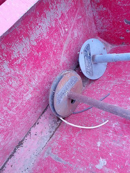

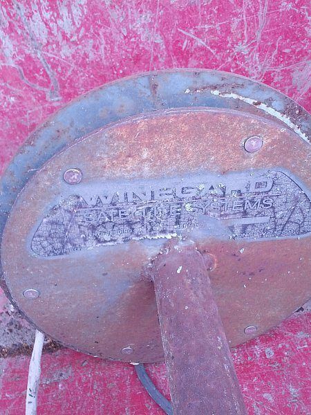

You may be in luck. I took mine off and made legs. It is rusted but still stiff. Four of the six bolts are still in it. Two missing. I can take some pics and give you some measurements if you are interested.
RT
OK. If you want my old one the cost would only be the shipping charges. I was going to upload some pictures with measurements but they just will not upload. Never had that problem in the past. Must be something new?
RT

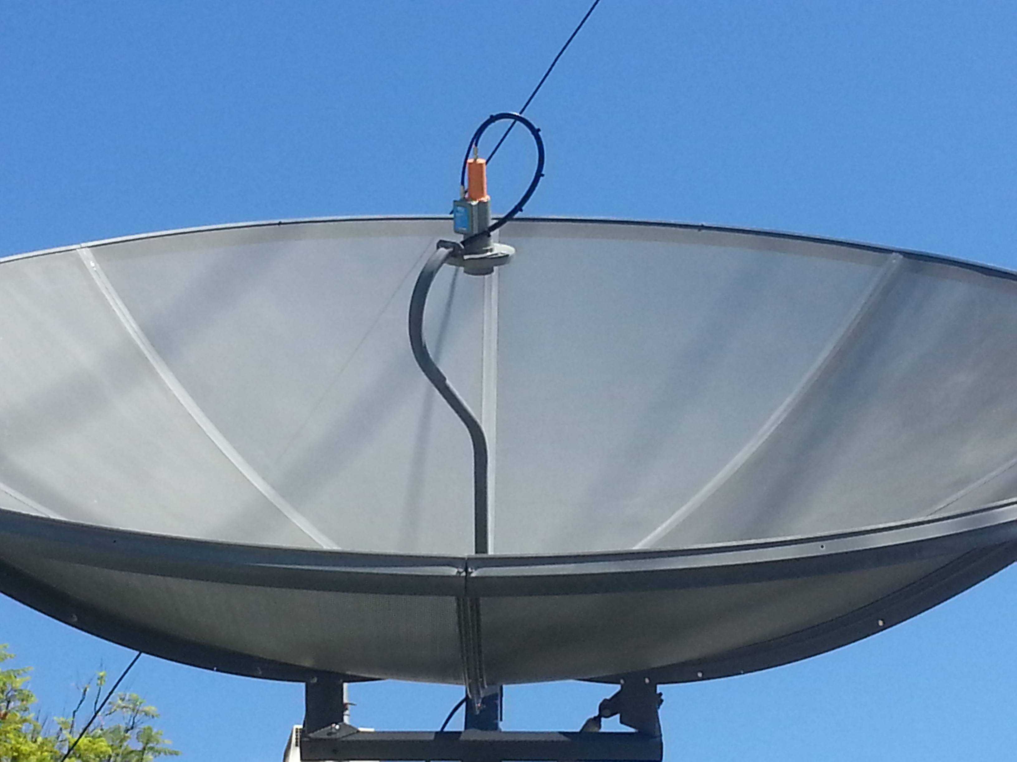

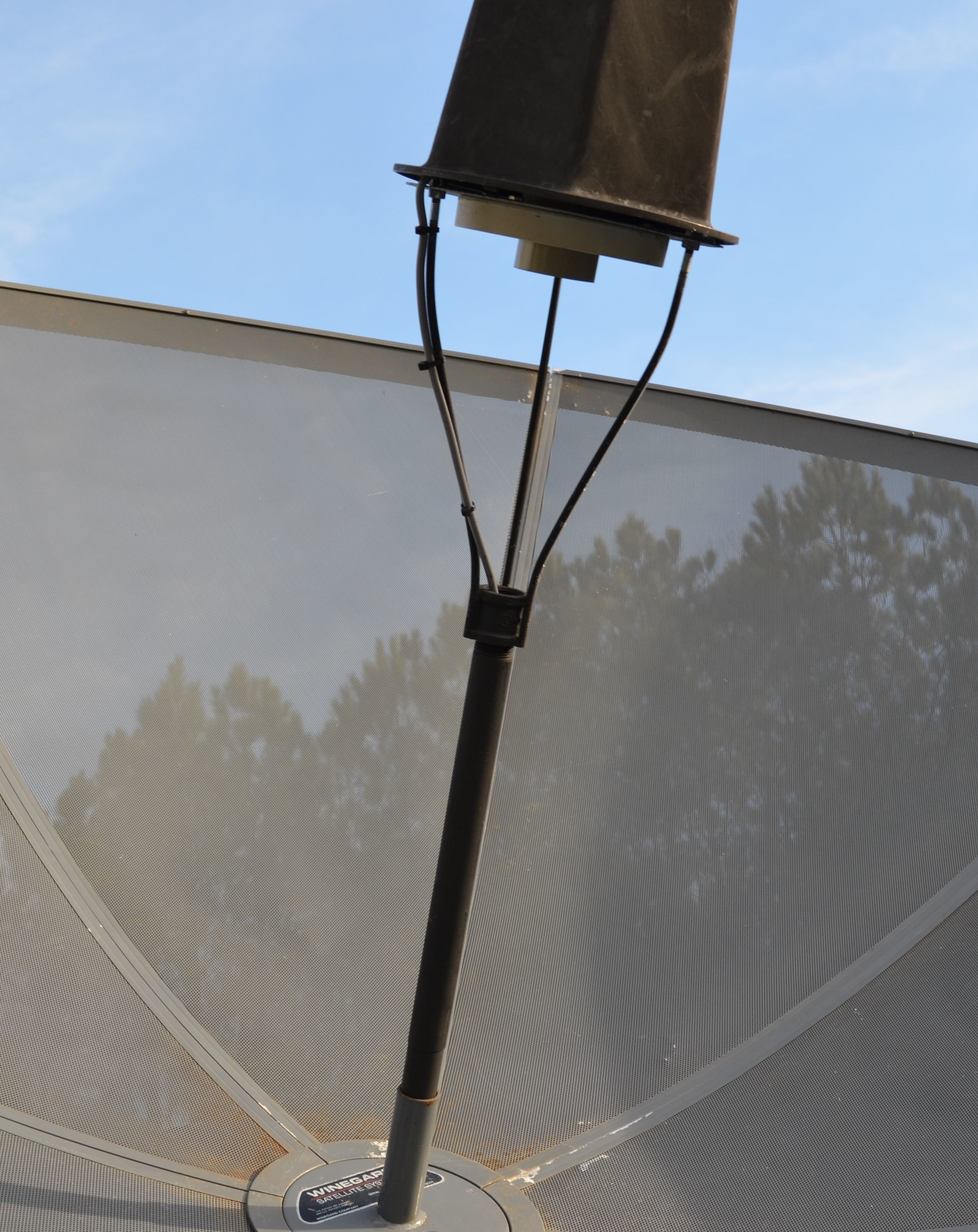

I just recently bought a used Pinnacle that was just down the street. What a nice BUD ... I'm very happy to be living under it now :D. In the Pinnacle Manual (downloadable here)(Page 8), it lists the "Assembly Instructions" for the "Quad Feed Support Assembly". You might find some useful information there. Mine came with the Button Hook Assembly (see attached picture). I'm certainly glad that nothing was missing. Got a nice Von Weise actuator with it too! Good Luck!

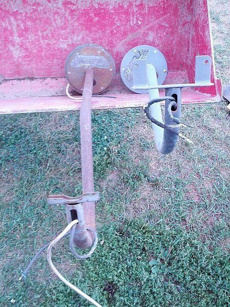

Here are the pictures of the two button hooks that I have per the email I sent you.

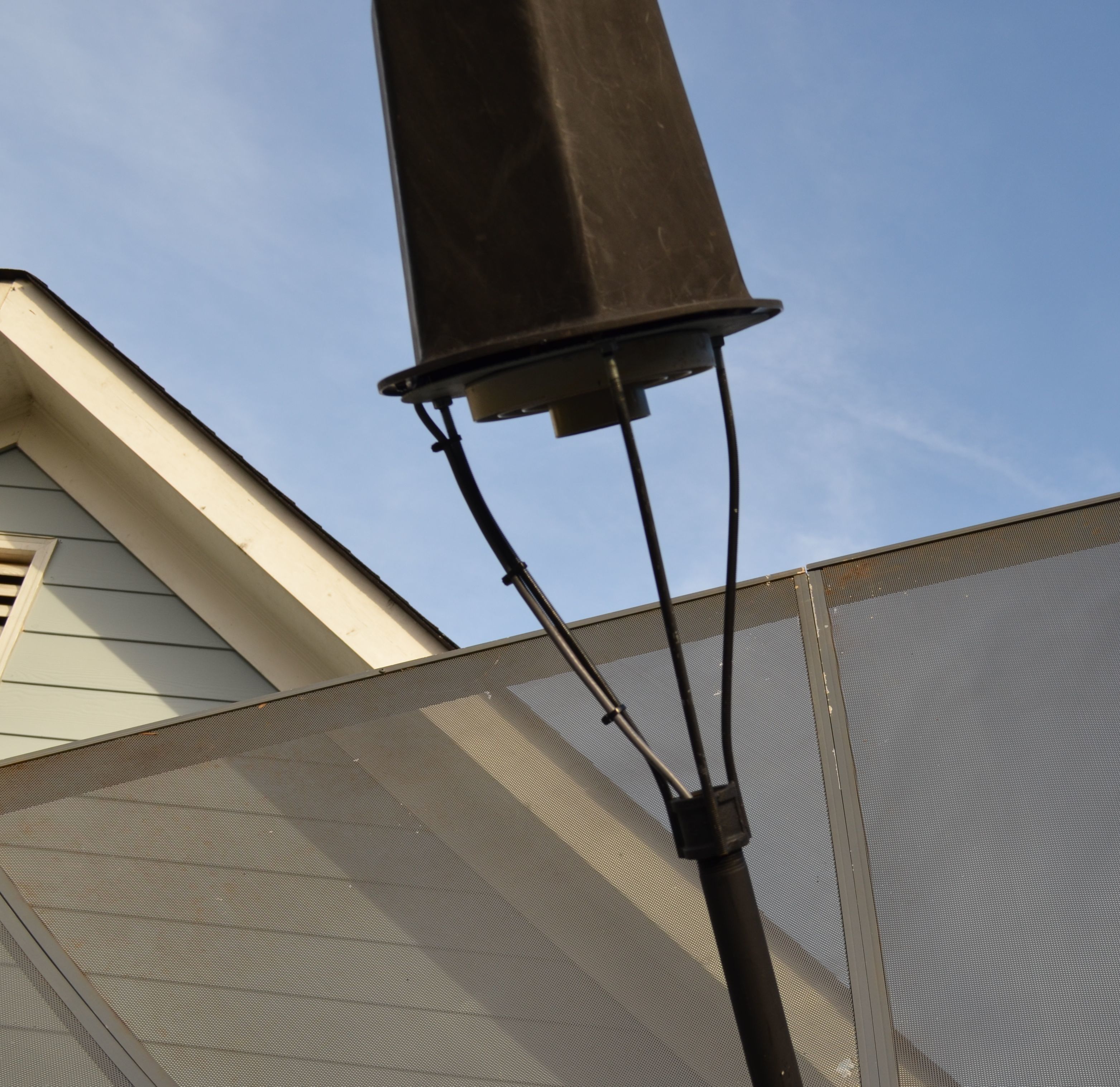

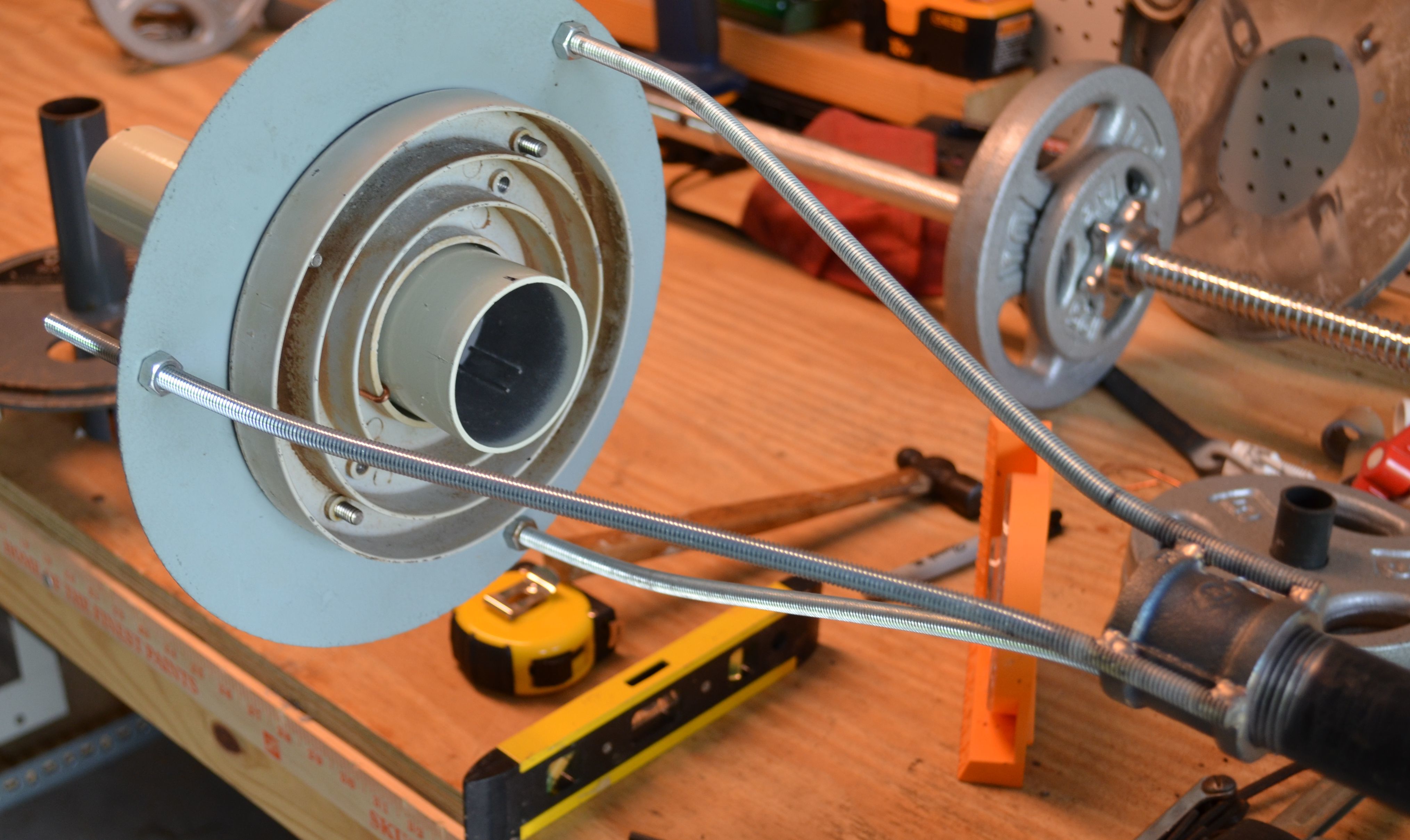

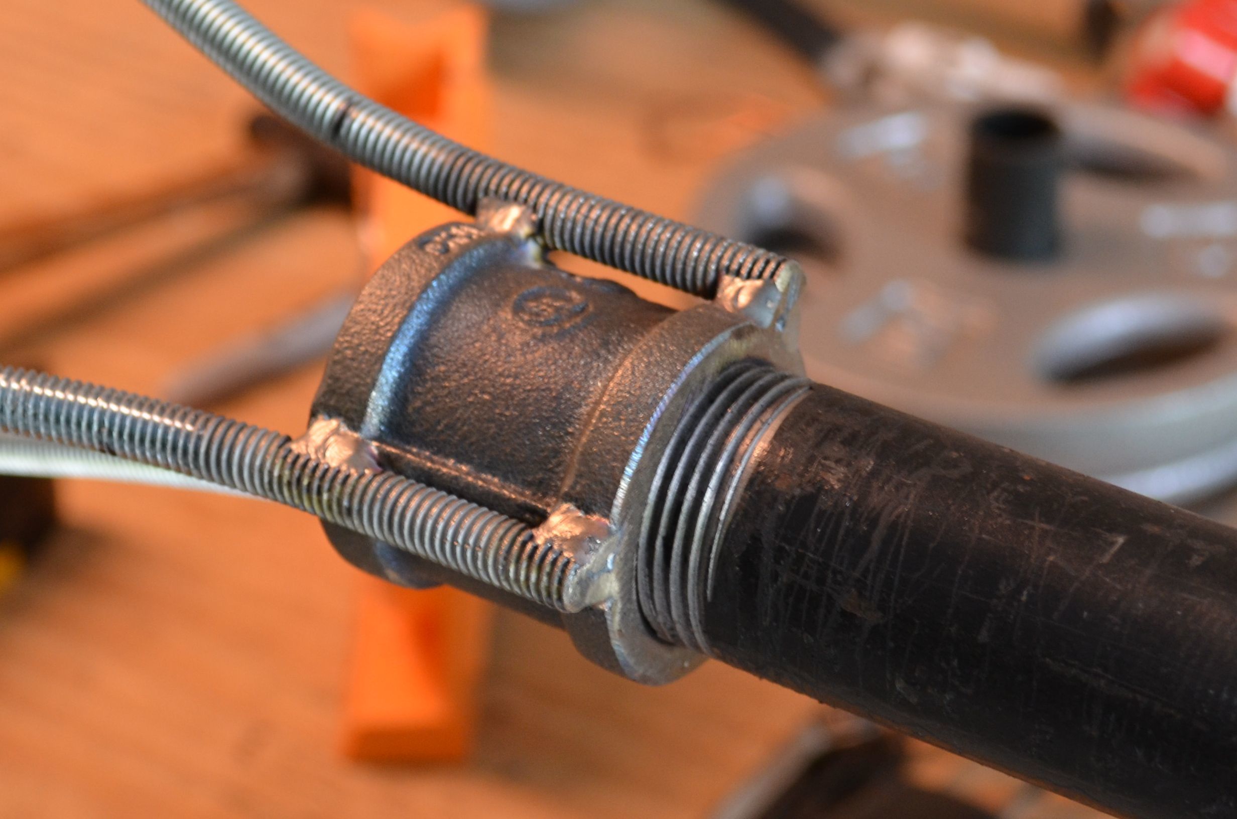

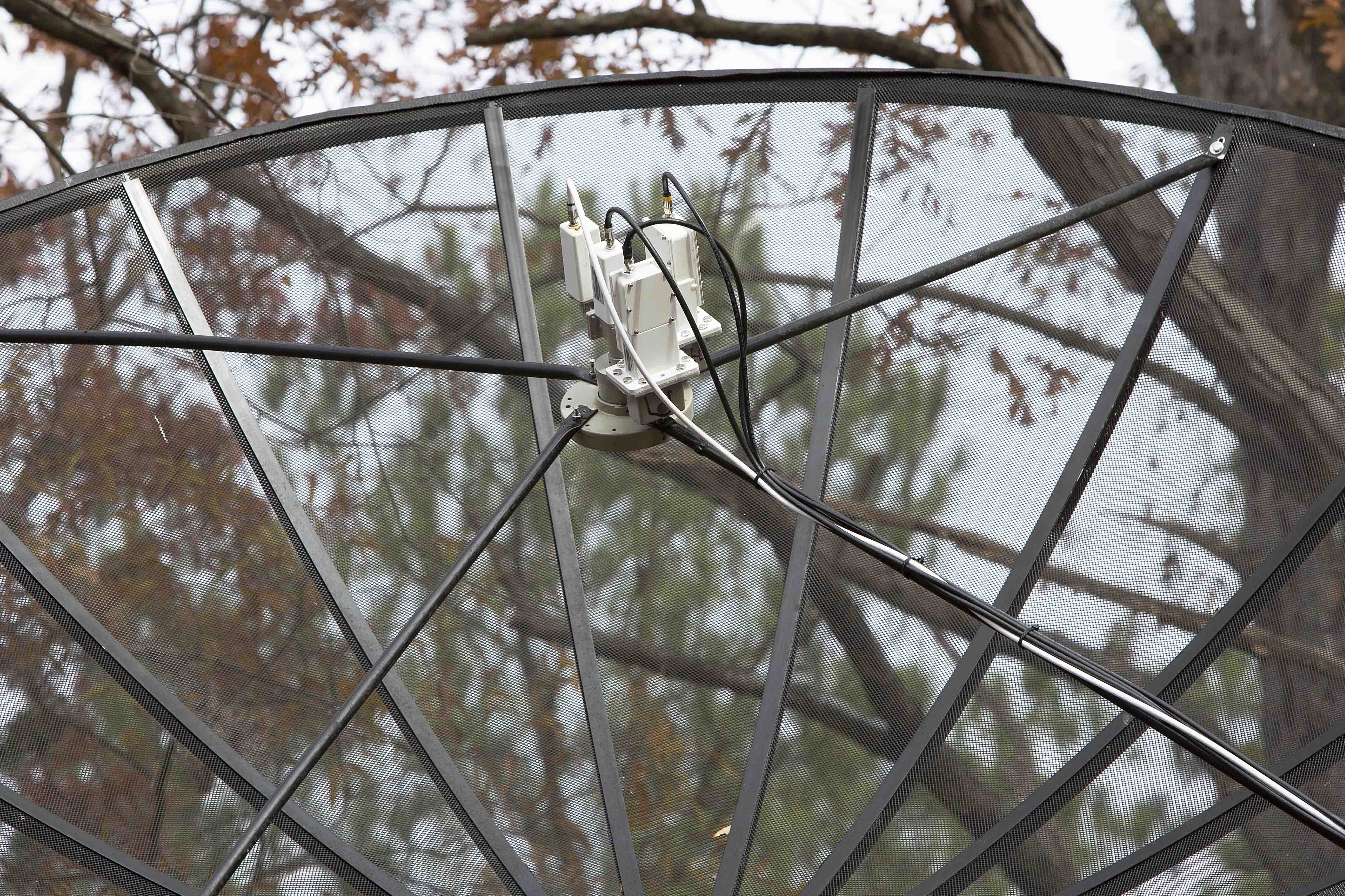

It has been a LONG time (over 6 months) since my last post on this. I got bogged down with work and I have had limited time. _ i finally got moving on this. I really could not find a decent replacement for the button hook, so I made my own. See pictures. I took a 1 1/4 " diameter pipe and had it machined down to where it would fit firmly into the hook support base, then had the support arms (5/16 all thread) welded onto a pipe coupler.. I had a mount like this back in the 80's so I knew it would work - my fear was with Ku band but as it turns on that is not a problem at all. Looks like a solid 75% signal quality across the ARC from 85 to 139. (139 is weaker cause I'm in the trees to the west...
Finally figured out how to attached the pictures..
