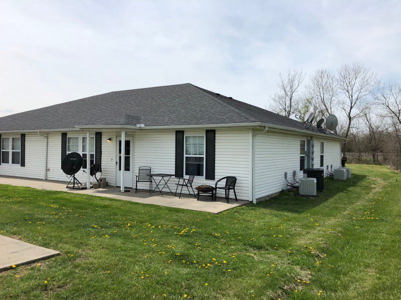

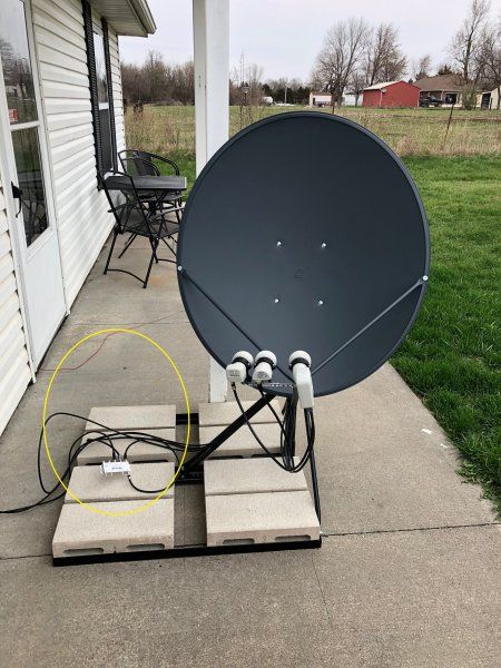

I've had a lot of problems getting 87 reliably with an offset LNB, because the dish is focused on 103. I get 103, 97 and 91 reliably. I got an idea this afternoon to mount a second dish on the other side of the non-penetrating mount. It has an opening for a 1 5/8" pole.
According to the SES website and Lyngsat, I should be able to get 87 with anything larger than a 50cm dish. So I'm looking at a 60cm dish. In fact, I may have access to an unused Dish Network 1000.2 which is 66cm wide. Anybody think this will work?

Just to be sure (your pictures are allways only from one side): there's no roof or pole blocking signals?
greetz,
A33
Not for anything east of 103 :)
The house blocks satellites west of 103, so I have a roof dish for 121 and 125

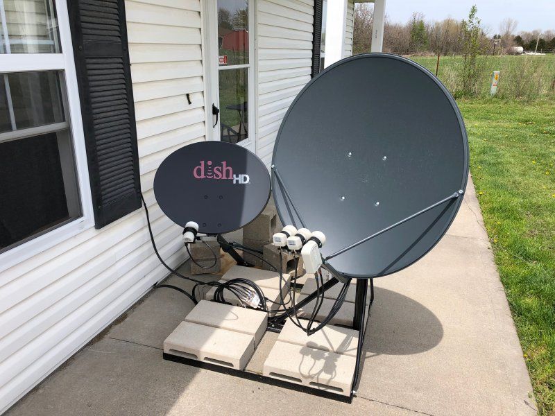

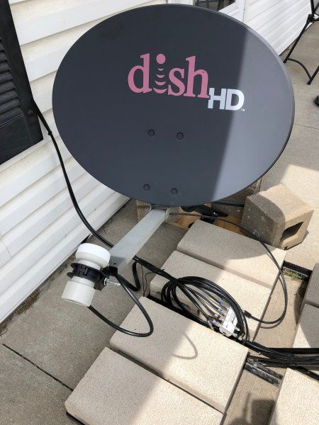

Well I had some time today so I decided to go ahead and try to see if I could get 87 on the old Dish 1000.2

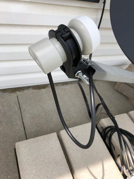

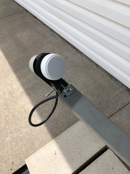

It took some time to tear the dish apart and retrofit a Maverick PLL LNB to it, but I finally got it ready and took it outside.
Getting 60% signal quality on the CNN mux and about 70% on the Florida Channel.
Not too bad for an old dish that wasn't being used for anything :)

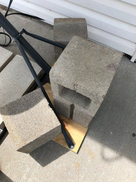

Not sure the wooden mount is permanent. Not too much rain or snow can get to it, but I'd be concerned about it rotting.
