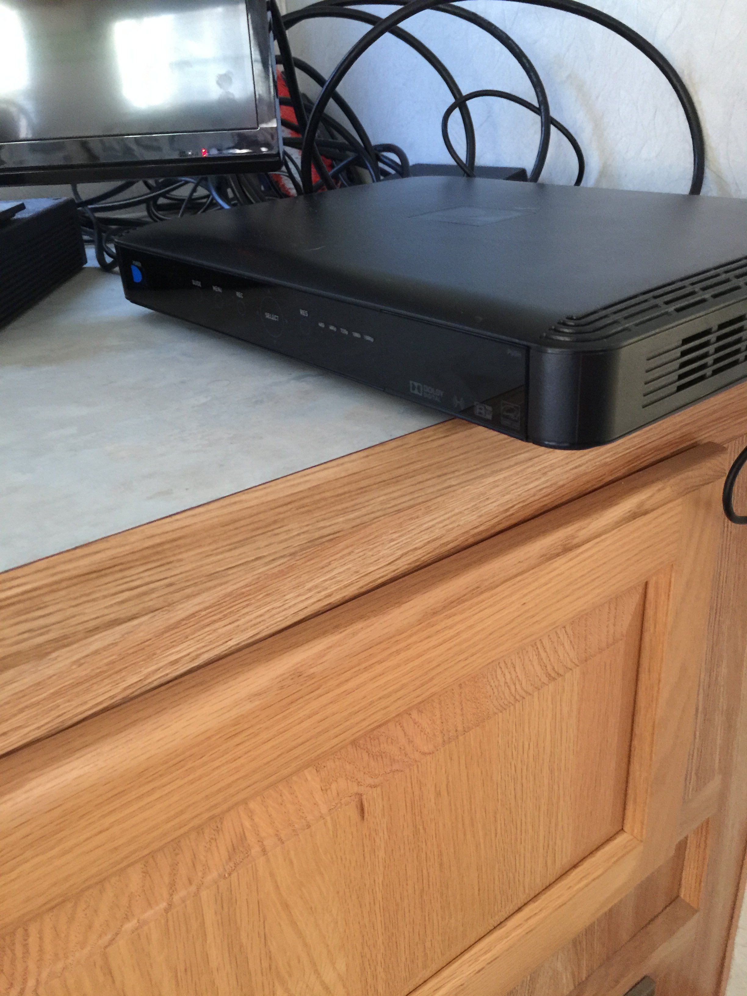

I have the receiver, power cord (with a brick in the middle) plenty of RG6 and also this SWM thing I wasn't sure I needed. I'll add some pics to clarify

I have the receiver, power cord (with a brick in the middle) plenty of RG6 and also this SWM thing I wasn't sure I needed. I'll add some pics to clarify. Not sure if I need the SWM piece at all- or should I hook the RG6 right into the box? (Looking for a good level to ensure it is plumb right now). Would it give me a 775 error if it's too far off from a satellite?

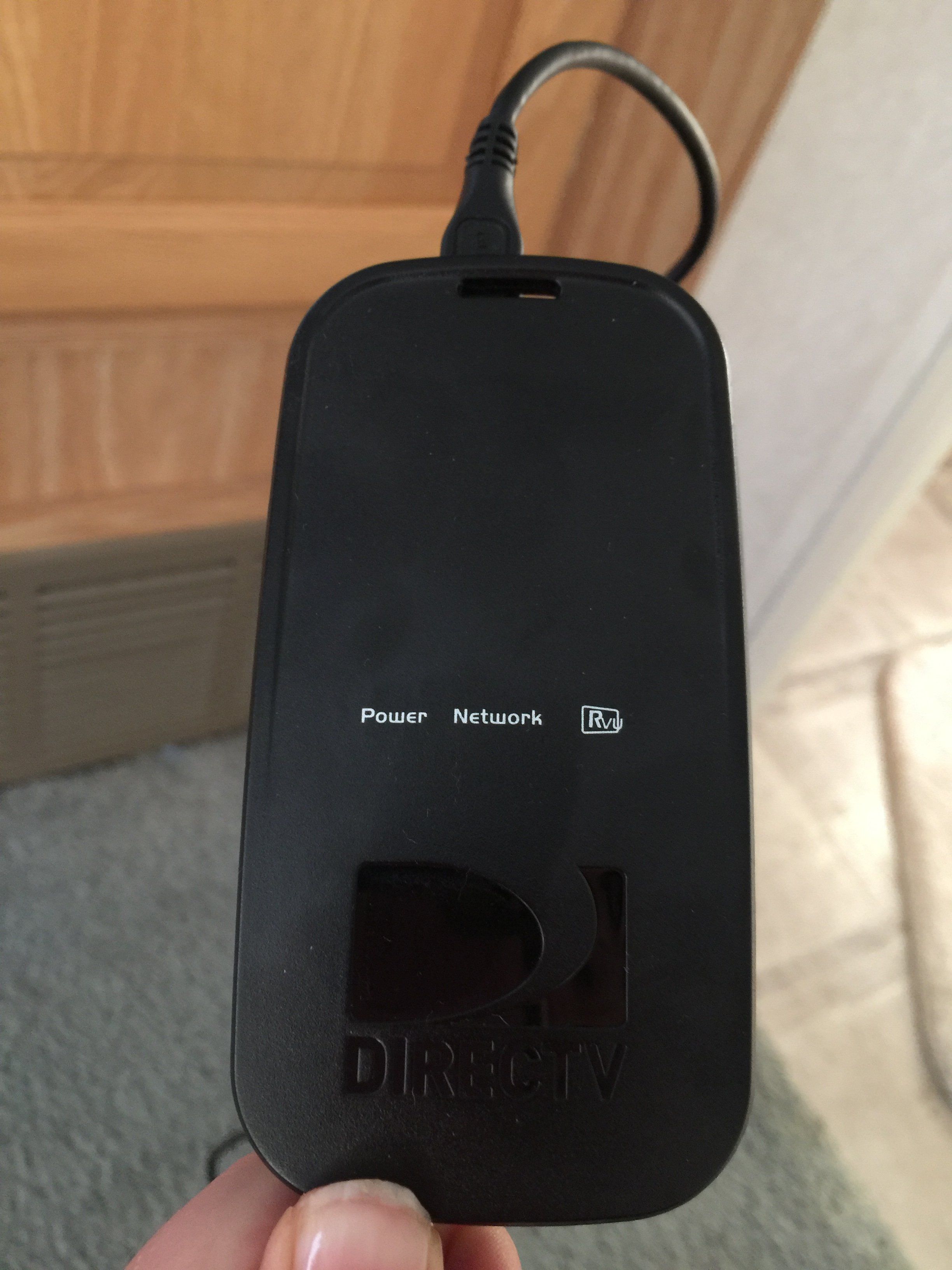

Yeah ...
The other device pictured there is not a PI, but a USB DECA module which is really irrelevant in this situation at a vacation home.
Unless you have and want to make a wired connection of the HR44 to the internet while there for VOD, program start over, apps, etc.

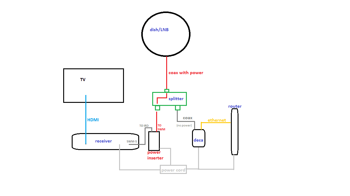

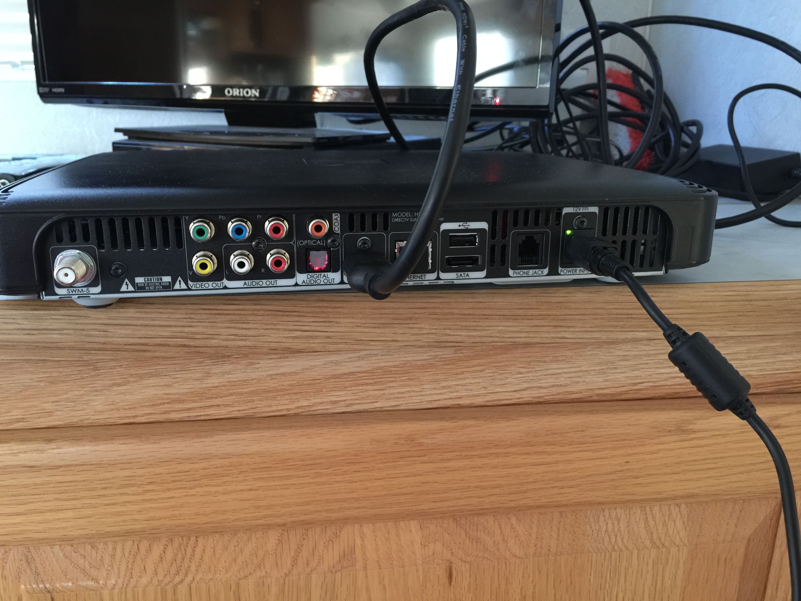

I see a power cord and a hdmi cable plugged into the back of your receiver but no coax. should have a coax line going from the receiver to the "TO IRD" port on the power inserter and then a coax line going from the "TO SWM" to the LNB. You do not need the green splitter with just one box unless you want your on demand to work in witch case you would need that and the palm sized box you posted labeled "power network rvu". Here's a picture with everything setup. Important to use red line as indicated if using the splitter. EDIT: just noticed you have a usb cord on your deca, you can plug that into the usb port on the back of the receiver to power the deca.
