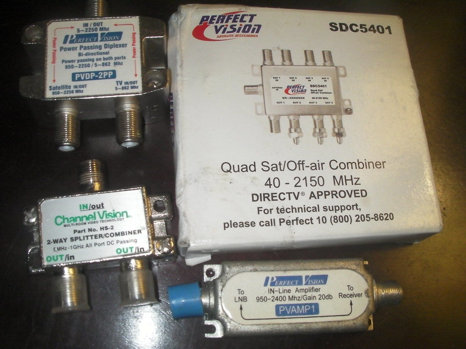

I am using a Slimline5 multi-switch and a PVDP-2PP to combine 99W and 101W. This works pretty good. By combining I am loosing several weak transponders on 101 but this is not a big deal as most channels are in HD anyhow.
But by combining 103W and 119 W I still have problems.
The readings for 103W are between 26 and 68 on (ca) and around 75 on (cb).
The 119W signals are 40-50 max.
If just one is plugged into the Slimline it works good and signals come through nicely.
By combining 103/119 with the PVDP-2PP I am loosing a hole punch of tps: all weak TPs on 103W and most of 119W.
While signals are a better near the Slimline (on a regular 6 foot cable to the receiver), the long 150 feet run takes an additional heavy toll.
Inline amps do not work at all, neither before the Slimline5 nor after; other combiners do not work any better either (see pic).

I am looking for 3 different power amps (Inline amps will not work sufficiently):
* between 119W lnb and switch
* between 103W lnb and switch (remember I am combining 119 and 103 with a PVDP-2PP before feeding it into the 6x8 and that combining causes signal loss)
* for the long run ca. 150' between switch and HR22
Currently I am using a slimline 6x8 but I could switch to SWM.
I am looking at these Sonora amps http://sonoradesign.com/ but this is rather confusing for my limited knowledge about frequencies.
