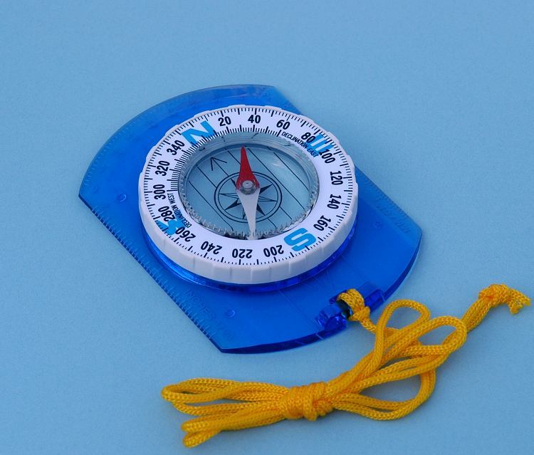

#1 Buy a decent heading compass as my attached photo shows. $12

This is just a VERY BASIC how to, you will find it real easy to do and can always come back for more details if you need them. Heck I bet I even forgot something here it has become so 2nd nature.
