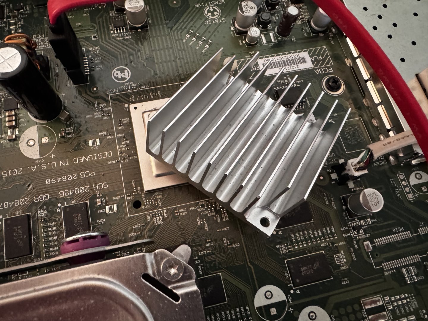

So I've decided to extract the old HD and use a SATA to USB to connect to the new H3. I opened the old H3 and this is what I found. 🤨
