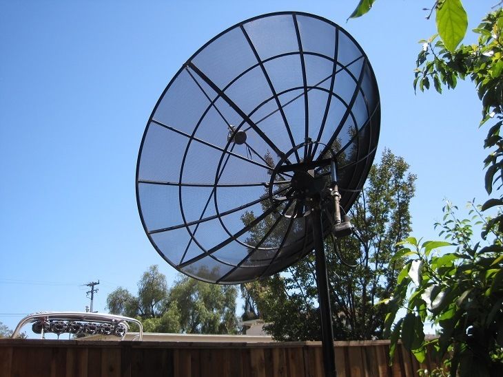

I started with a 10-foot C-band dish system built from surplus components in 1995, and I upgraded it over the years (C/Ku, 4DTV, and a separate FTA receiver/dish/motor that I never got working right at first). Now I have a new FTA receiver, and I am thinking of upgrading and combining the system. What do you all think of this plan:
-Replace Chapparal Corotor with dual-output C-only LNBF on the 10-foot dish (abandon Ku on it)
-Connect one output to the FTA receiver (through a DiSEqC switch), the other to the 4DTV receiver (set to C-band LNBF)
-Use a Vbox with the FTA receiver to control the 10-foot dish
-The 4DTV receiver will be used for 105 only, or any time I want to look for NTSC feeds
-The FTA receiver will also be connected to my 76cm dish/SG2100 motor
Thanks for any comments or advice.

What is the 10' dish?
Show us a picture.

Thank you for the detailed notes, Anola and madmadworld. The dish is the one in my avatar, but I posted a bigger picture below. My C-band LNB is indeed a Cal Amp, 25 degrees, bought in the late 1990s. The Ku on the 10' dish is an unknown one, maybe from SatMart around 1997-2000, 0.8 or 0.7 dB maybe.
I do plan to replace the Ku dish with a 90-120cm one. Its LNBF is an unknown model, it came in the package deal with the dish and Satwork ST3688 receiver in 2004-2005. I actually bought those direct from an Ebay seller from Roseville or Carmichael here in California and met him there while I was working nearby, so it could have been Brian from SatelliteAV even, if he was in the business already then.
The receiver is an X2 Premium (it was cheap to get me re-started in this hobby), so I cannot control the Polarotor if I kept it except from the 4DTV DSR-922 receiver, and that is a pain to do.
I figured to use a DiSEqC switch (1) because I already have a four-port one (Spacelab DS-41), and (2) because I have two other Ku dishes that I may want to add at some point, so I would need more than two switch inputs. Anole, your switch diagrams were very helpful. Would a 22 kHz switch be more reliable? The other dishes are a fiberglass 90cm (with no LNBF yet) and a Primestar oval with its original LNBF. Both of those seem to be too heavy to put onto the SG2100 motor, but maybe a Stab HH100 or HH120 could handle one?
