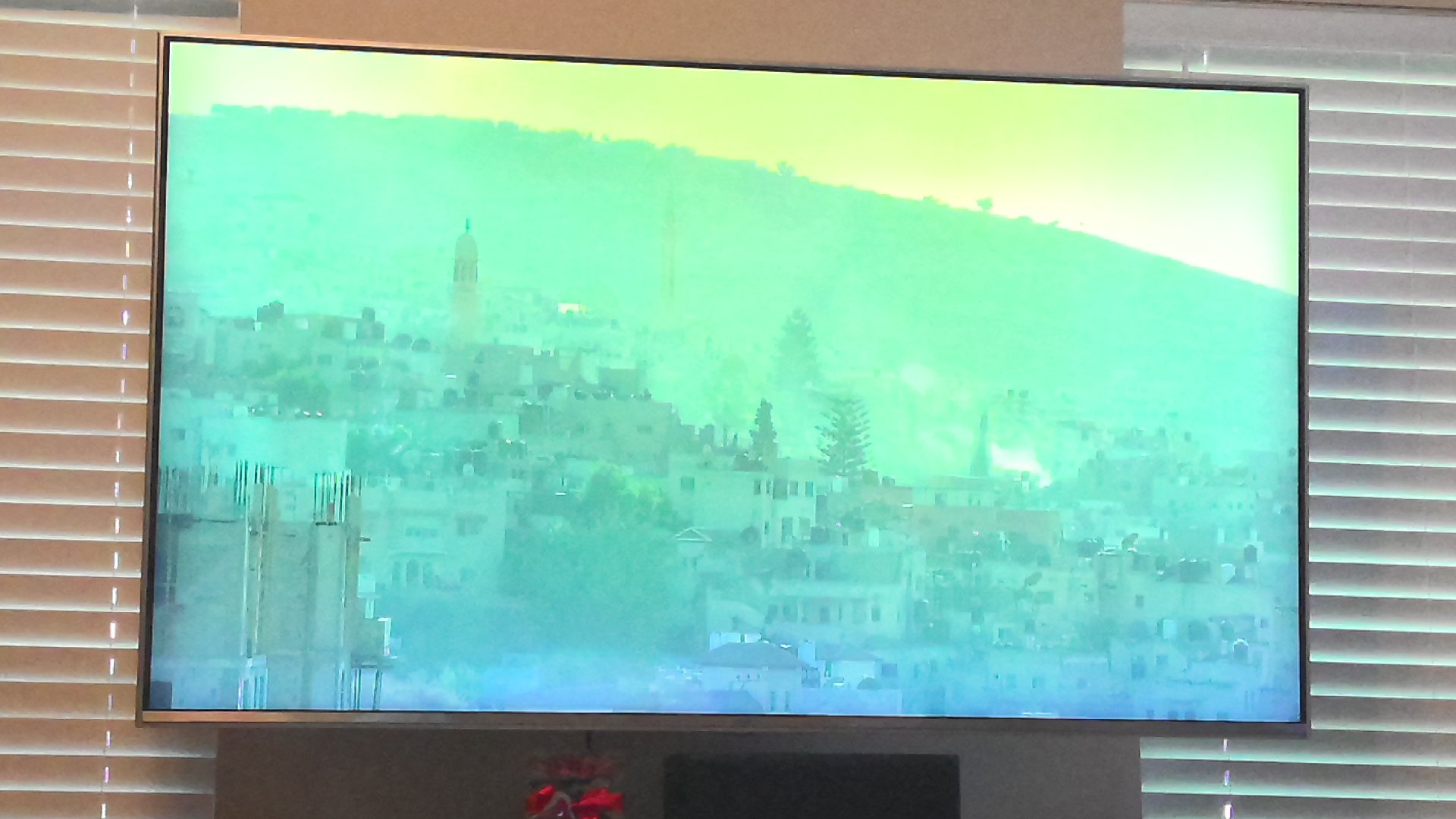

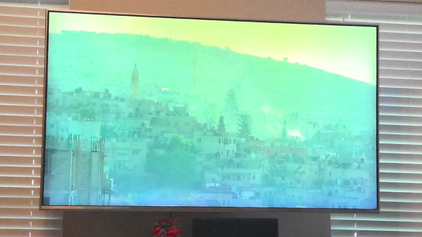

Success! DirecTV slimline, with a universal LNBF. Looks pretty weird due to the 47.7 degree skew.
They are showing an outdoor view of a city with smoke. I'm guessing it's Gaza.

I assume it's Gaza too. They run that cam overnight. When news happens, they interrupt to show live feeds. You don't need a universal LNB unless you want to scan for data tps below 11700 MHz. But if that's what is available, it's good to use.
