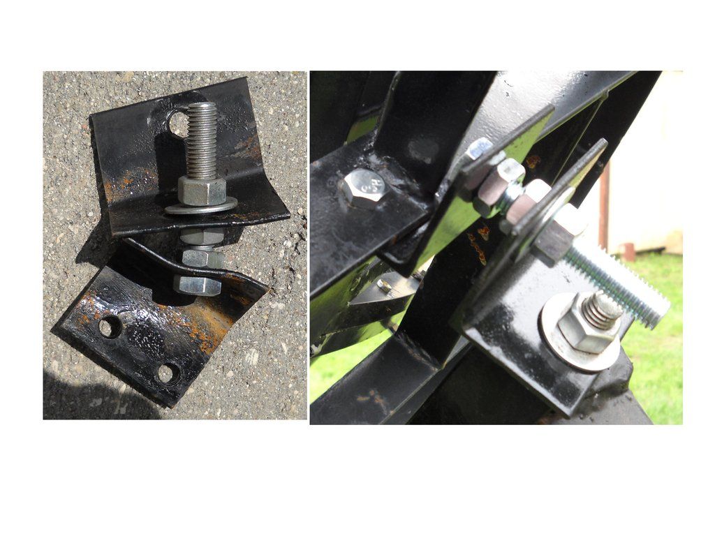

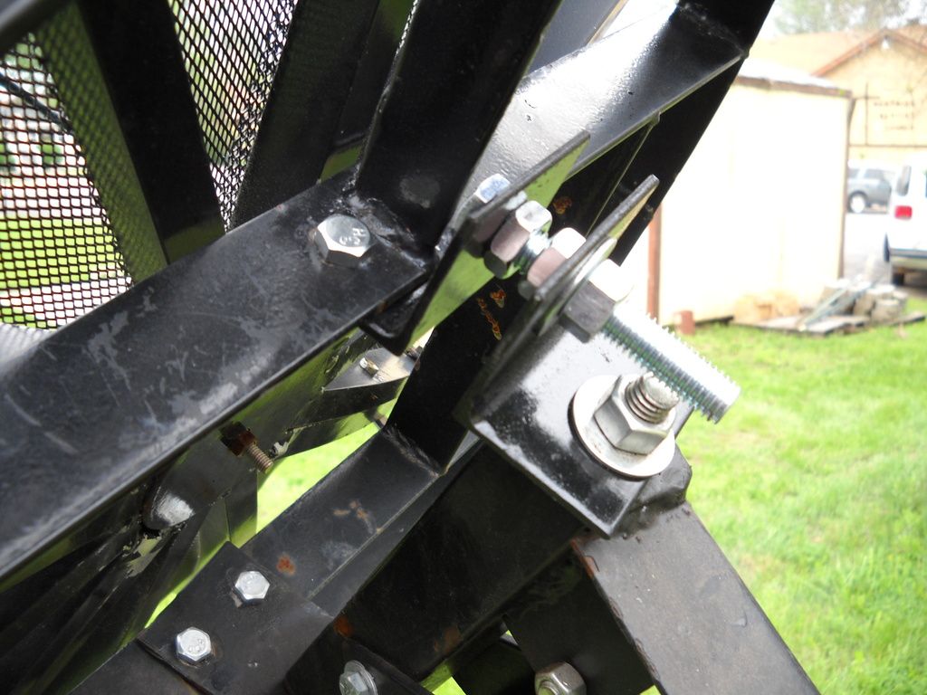

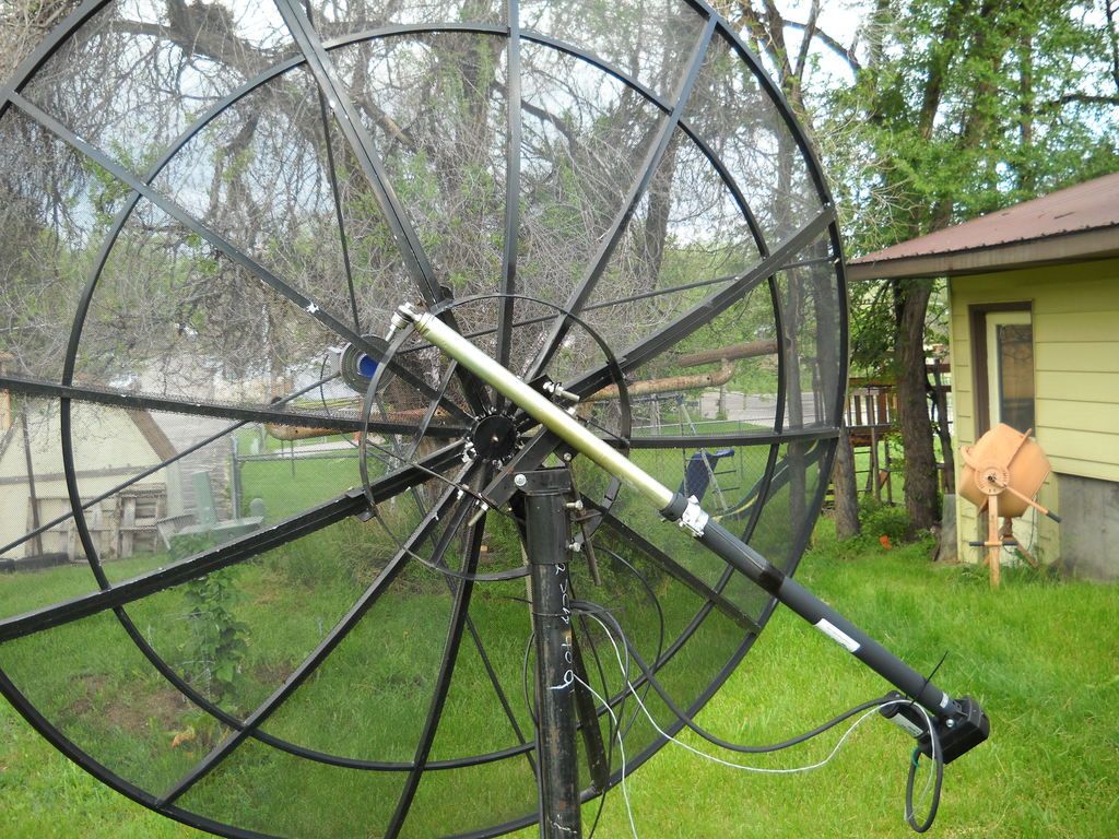

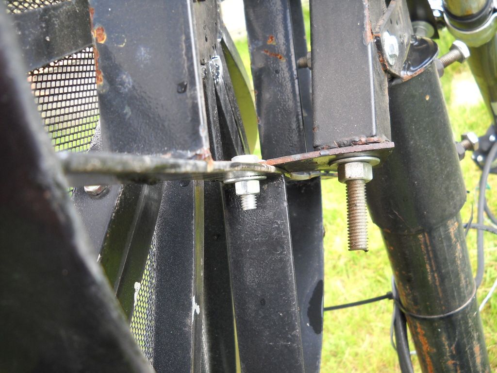

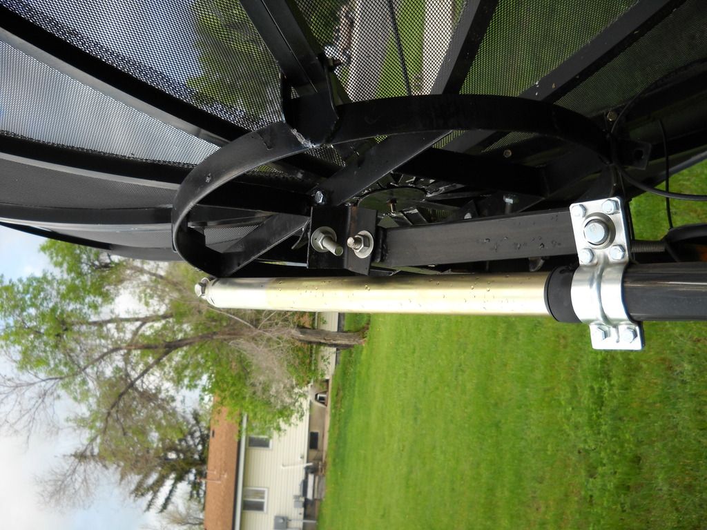

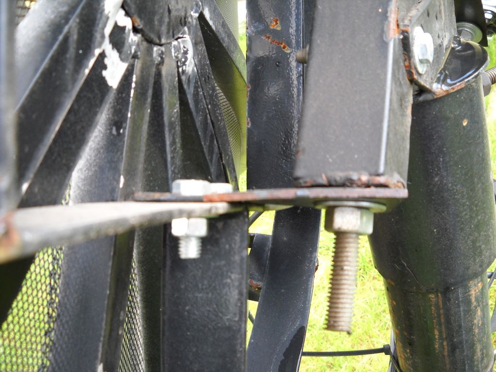

I had promised to upload some pictures of my dish damage, so here they are. Also included are pictures of the repaired dish.
As a side note, I had contacted to Tek2000 to inquire about new mount, just in case it turned out that way. They responded and informed me that they had beefed up their mount from what I have. Just thought I would pass that on, in case someone was thinking of buying one from them.
The following pictures tell the tale of WHY YOU SHOULD SET THE MECHANICAL LIMIT SWITCHES.

Like that cement mixer in the background... Been looking for something like that at auction sales up here, no one ever wants to get rid of them!

The cement mixer is Harbor Freight special. I don't remember what I paid for it, but it wasn't all that bad.
