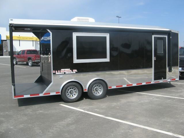

My "RV" is actually a custom trailer built for competition BBQ. There is no splitter in the wall. So it sounds like going to the Hughes HD/DVR tuner won't be an issue with on input.
Thanks!

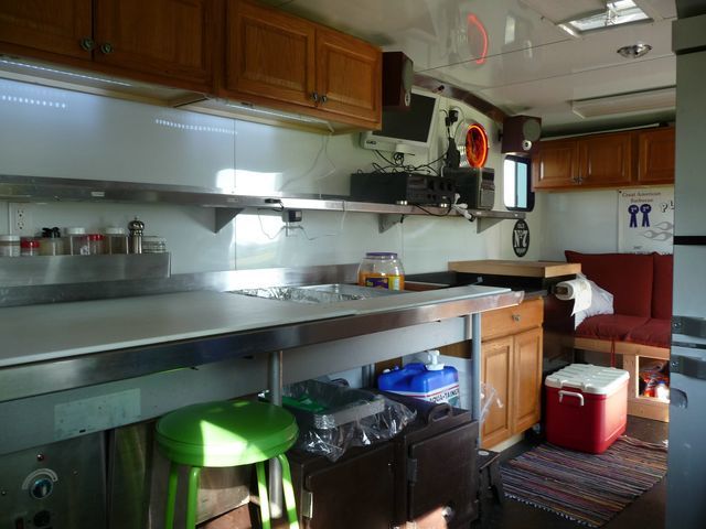

Yup, not important. Just want some content to watch. Local channels over the air aren't cutting it.
Only if you plan on using one tuner and not have the ability to record one channel while watching another. I didn't realize that you were talking about one receiver...my bad. ;)
Yup. Recording isn't important. This is more of a mobile kitchen than an RV.
